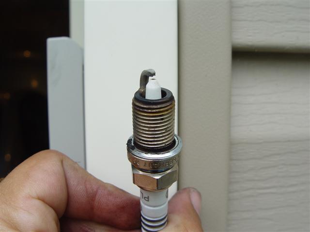

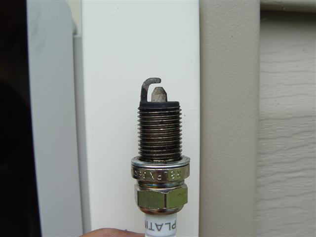

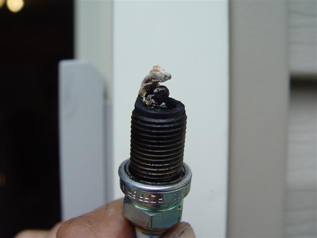

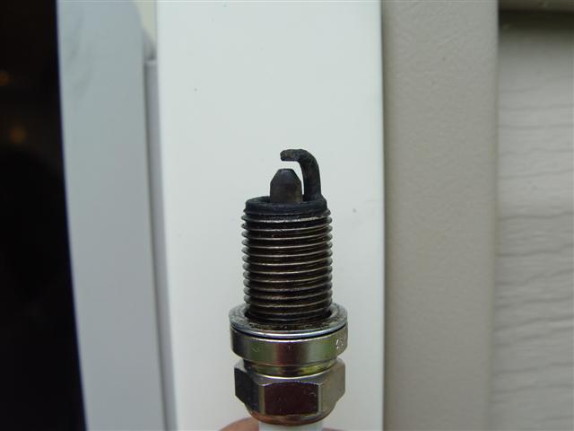

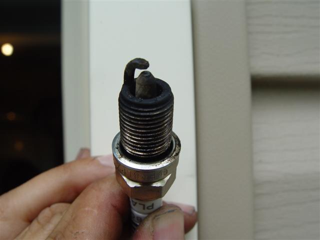

I have a Civic 2003 with 141,000 miles. Long commutes of 160 miles each day. I have noticed lately an increase of oil consumption and also had to change spark plugs due to hesitation during acceleration. After pulling the plugs I noticed that the plug from Cylinder #3 had ash deposits and some oil fouling (see picture NKG plug picture). I changed plugs and today I pulled them again to perform a compression test. I found again oil fouling on the plug of cylinder #3 (see pictures Bosch). I include a picture of typical plug of the other cylinders.
I noticed that the old and new plug on cylinder #3 show more accumulation and fouling on one side of the plug. One side looks cleaner.

Except for pictures DSC02225 (which is a plug from a different cylinder which shows the typical current state of the 3 other plugs) and DSC02228 (which is the old plug I took out from Cylinder #3) the other 3 pictures are from the same new plug I put in 200 miles ago showing it from different angles.
I do find oil residue on the plug from Cylinder #3, do you think it could be a fuel issue?
