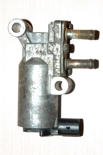

When i pull the sensor from my IACV, the car shuts off but its revs up and down and up and down with it connected. I advanced my spark to keep it running but it will still do it but will stop after a while of driving if the lights are on but the rpms sit at 1100 and it sputters to accelerate. Any Ideas?

I got the brand new IACV. It helped somewhat but was still surging a bit. A friend of my brother, imports hondas and he loaned us a MAP Sensor and a TPS. Come to find out the TPS is bad so I changed all the sensors one time while I was at it. Started the car and she ran with no surging. I pressed gas and the car was pushing out a load of white smoke constantly so a friend of mine who does mechanics diagnosed that a blown head gasket is the culprit. So I went and got a full set.....so we will be changing all of the seals, rings, etc. Once this is done I should be ready to go. Since I have gotten this car I have basically changed every part imaginable on the engine. I'm thinking I may go ahead and change the O2 sensors while I'm at it and the Distributor Cap. I'll keep you guys posted.
