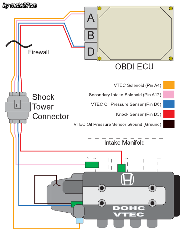

what i do need though is the VTEC SOLENOID SETUP for the D16Y8. IDK what or how this dude has it rigged in here.

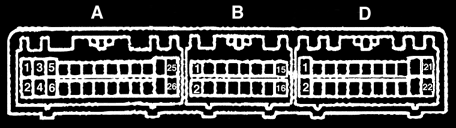

  #50
wire up a4, d3, d6
