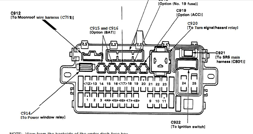

Check whether fuse 24 under the dash is blown.

Alternator and battery are almost new. put new ones in like 6 months ago when i got a new motor. i got the batt and alt. checked at autozone and they are alright... ill try replacing the old ground wires with some 0 gauge power wire tomorrow at work... the air filter has a metal mesh on it and it sits right above/ rests on the starter... i dont know how but could it be shorting it out through there? isnt the fuse 24 under the dash a SRS fuse anyway?
Old Nov 13, 2008 | 07:58 PM
Originally Posted by vtecaddict
...isnt the fuse 24 under the dash a SRS fuse anyway?
Yes, fuse 24 also protects many other components related to your problem (alternator and VSS/speedometer):
