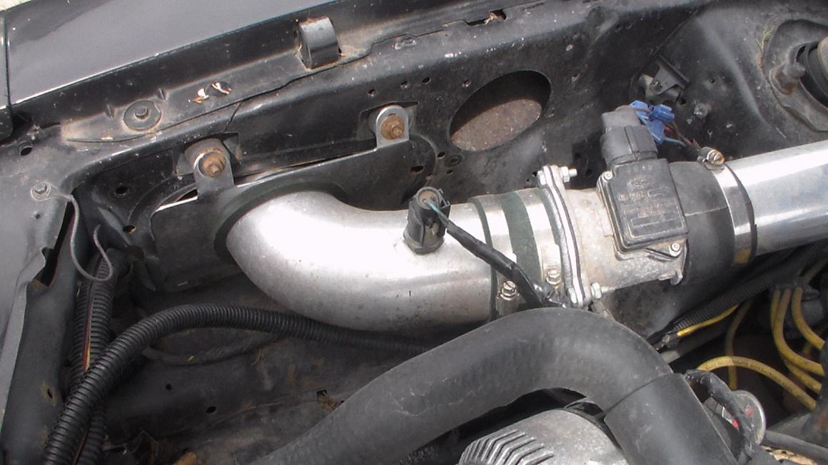

I got away with a ebay filter system on the Stang cause it came with a plate to block the hot air and the cone filter is in the fender. Had to modify it tough. Cut it up and also had to drill and tap for the air temp sensor. Attaching a photo for reference. If you decide to go with a stock filter try speed by spectre. They are more affordable than K&N and work the same way.
If the lady's tube has a hole in the tube its probably cause something is missing? Not very familiar with that car.
