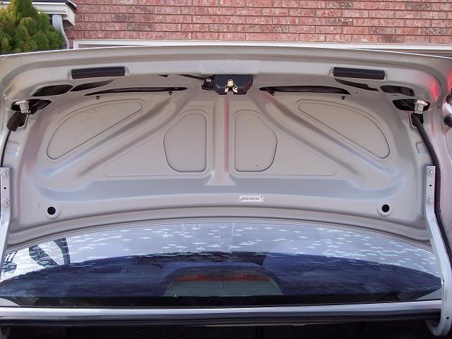

anyway.. i got a picture of my truck assembly.. not exactly sure where to drill through..

dont need caps
the holes need to line up with the holes on the spoiler when placed on the boot(trunk)

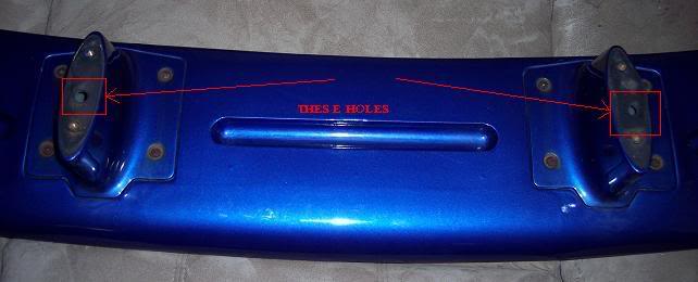

The Holes:
ok now these are the holes that i was talking about you have to place the wing on your trunk, exactly where you want it, EXACTLY, mark where the"legs" of the wing sits on the trunk,exactly. Maybe with some masking tape or blue tack, something that wont damage your paint work.it looks like the legs can be unscrewed, unscrew them and place them where you marked them out before, then put a pen or similar through the leg and draw on your trunk through the holes.
remove leg bits from car screw them back on to the wing so you dont lose them , and put the wing to one side. Now comes the point of no return, get your drill and metal drill bit. It may help if you put a piece of masking tape on the spot you are going to drill to stop the bit sliding across your trunk, and leaving a very fetching scratch. Drill the holes.
take a leg back off the wing drop bolt in the hole, and then bolt (with leg bit attached) through one of the holes you drilled on the trunk (making sure its the right side) put the nut on the otherside of the bolt, tighten. Do the same with the other side.
Hey presto... your civics got too weird looking growths
Then screw the wing to the leg bits.
I hope this helps and was a bit clearer, im not really sure how to make it any clearer other than flying over to the US and showing you
