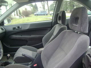

Swapping rails will not be a problem at all. I have Integra cloth seats right now for the fronts. You only have to swap the inside rails of each seat (2 rails total). Was this the write up you are speaking about? This is what I used to swap mine in. Remember, you only have to swap the rails closest to the center console on each seat.
Check this DIY if you haven't yet:
https://www.hondacivicforum.com/foru...=integra+seats
Here's a pic of what mine look like.
I am used to them now, but when I first sat in them, I was in love. The lumbar support is the best thing about them! (Well, at least the driver seat... no lumbar control on the pass. side)
