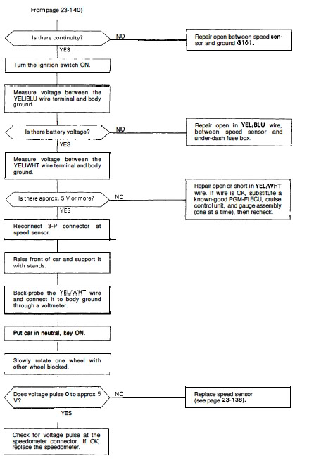

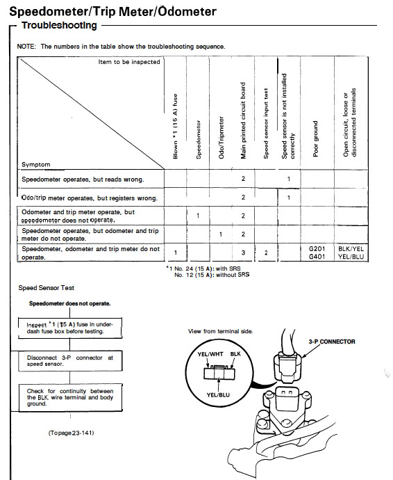

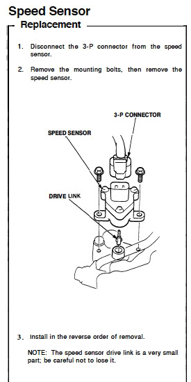

If fuse 24 is not blown then, most likely, you all have a problem with the VSS or its circuit.

Ok well i know it's not a fuse for me, as my accord came back from the dead a couple of times and i have already checked all the fuses and they are all working ok.

Originally Posted by WILMER007
Ok well i know it's not a fuse for me, as my accord came back from the dead a couple of times...
Good point. Check the VSS and its circuit.
