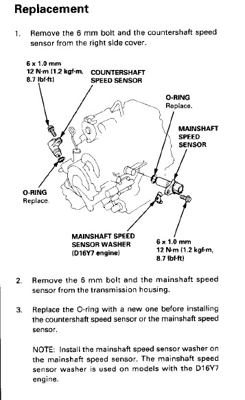

Speedometer is not working. Been told that it is either a fuse, or a speed censor problem. Fuses are o.k. so i am left with the speed censor idea. My question is how do i diagnose weather my speed censor is in need of replacement? If i do need to replace it, how can i do this myself. If anyone can help that would be amazing. Thanks

I never replaced one, but i found this, hope it helps.
