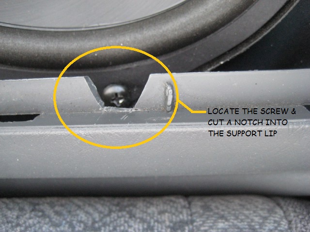

Now, with the grills off, you'll notice the speaker screw closest to you is slightly under the support lip and the other one near the middle of the rear deck is further under the rear deck. For the screw closest to you, I simply took a pair of nippers and cut a notch in the support lip in order to access to it with my screwdriver. This notch is covered up once you put the speaker grills back on.
Get a right angle ratcheting screwdriver at Lowe's similar to this: Amazon.com: 8 Piece Right Angle Screwdriver: Home Improvement and you'll be able to get under the rear deck and remove those two screws (one per speaker). The other two, fully-exposed screws are easy. Swap out the speakers and put everything back together. If you didn’t break any of the other tabs along the grill edges, the grill will snap back and stay in place. If they're loose fitting, you can take some weatherstripping putty and place a few small pieces along the support lip to hold the speaker grills in place.

I finally got a chance to take pictures of the speaker replacement in the rear deck
Hope this helps.
