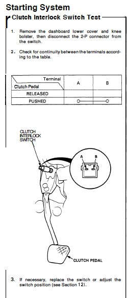

Old May 3, 2010 | 09:23 AM
Check the starter switch at the top of the clutch pedal:
Old May 3, 2010 | 09:40 AM
roland@southsidegraphics.com's Avatar
Joined: May 2010
Posts: 3
hey thanks that kinda makes some sense because lately i have been seeing rubber parts on my carpet and i thought it was from the brake but i looked at it and they had put a screw there so i never knew where that came from so now i know that might be my problem
Old May 3, 2010 | 09:43 AM
...NEED4SPEED...'s Avatar
Joined: Feb 2010
Posts: 428
From: Austin, Tx
i agree with ronj... check the switch... (i had the exact same problem awhile back) but right before u check it, see if the rubber stopper thing on the clutch pedal is not broken off. cause that was my problem and not the switch.
Old May 3, 2010 | 11:55 AM
mk378's Avatar
Posts: 10,023
You can just unplug the switch and jumper the plug to bypass it for a test. If that turns out to be the problem though, it is a very good idea to fix it properly. At some point you're prone to start in gear and crash into the car in front of you.
Old May 3, 2010 | 06:05 PM
Joined: May 2010
Posts: 3
Thanks everybody it ended up being the rubber stopper that broke. SO I installed a screw in there and it works perfectly!!!!!
