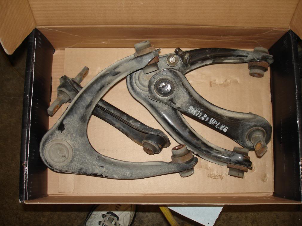

these are your STOCK CAMBER KITS....

no adjusting them at all... if your cars been wrecked then most likly your upper camber arm is bent... or maybe your spindle is bent. no telling without actualy seeing the two parts...
if you have stock suspension and gonna keep it stock then just buy a new upper arm and HOPEFULLY your bushing isnt seized on the spindle and its a quick and easy swap. if its seized ya got more issues and taking it to the shop would be the best unless you have some tools...... like a hack saw with a hardened blade and lots of time. and a welder helps as well IMO. i had to chop quite a few seized bushing/bolts in my last 2 years with 2 civics NOT FUN WORK! i cut the bushing clean thru kinda close to the middle bushing as much as posible, then when its removed with a nut weld it to the remainder of the bolt that goes thru the threads and weld it to it and then after it cools alittle then crank it off with a wrench. its most likely not seized but the bolt/bushing part is....

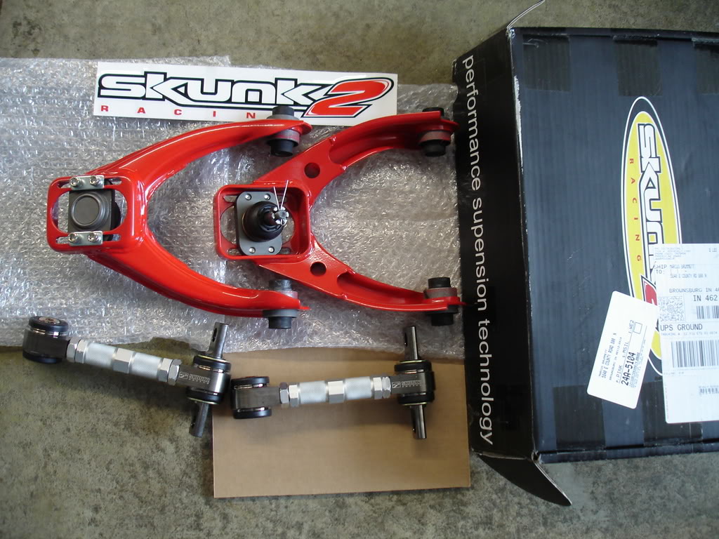

these are some nice camber kits that i bought. SKUNK2 kinda costy but i splerged.
for a cheap budget minded camber kit. click that link. i used there rear toe adjusters on my last civic and they worked great no issues.
i thought about going with them again BUT for the SKUNK2 name and more abuse and adjusting id be doing somewhat often i chose not to cheap out...

ok then i would go ahead and buy a camber kit at least for the rear first to fix your bent problem now (well after ya get your wheels off.)
depending if you want cheaper camber kit or ya want some quality camber kit is all up to you. id recomend the skunk2 kit since it does look alot better quality and very well built!
