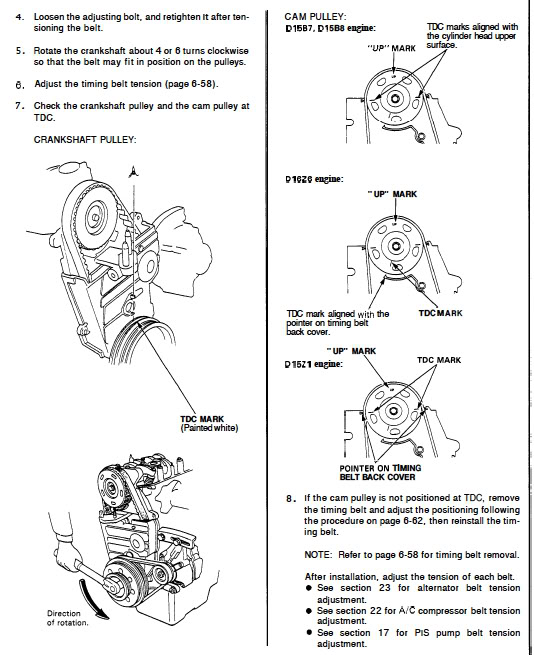

If you have bright spark and fuel pump primes, then check whether the timing belt slipped a tooth or two. If so, the camshaft gear and crankshaft pulley will no longer be synchronized at TDC for piston #1. This test requires removal of the valve cover and upper timing belt cover.
