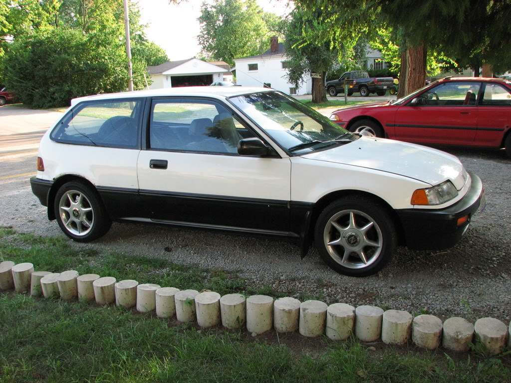

I purchased an 89DX hatchback about2 months ago. It has 236K miles on it.
This morning on my way to work the engine blew. The car looks nice and everything else is good on this car. I work in the automotive industry, I have air tools, and have extensive auto repair knowledge. My question is, what engine can I put in this car ie. what years and engine sizes are compatable with this car. It had a 1.5.
