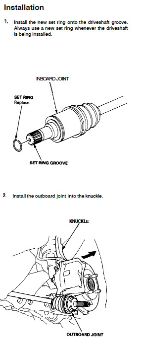

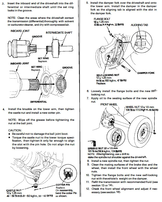

doing a tranny swap on a 96 Civic Ex auto. Before I remove all the main seal bolts, I need to remove the drive shafts....was wondering about a "How To". I got the main hub nut off and the drum and caliper off....whats next?
Is there snap rings somewhere and once I get the hub outa the way should the axle just sliiidddeee out of the tranny? lol
Old Apr 2, 2010 | 02:45 PM
it just pops out with a little help from a screw driver
Old Apr 2, 2010 | 02:59 PM
^^^Listen to this guy. He knows Hondas.
