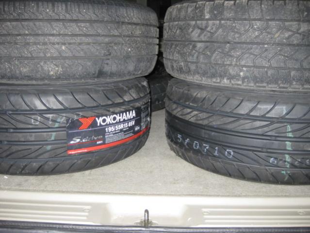

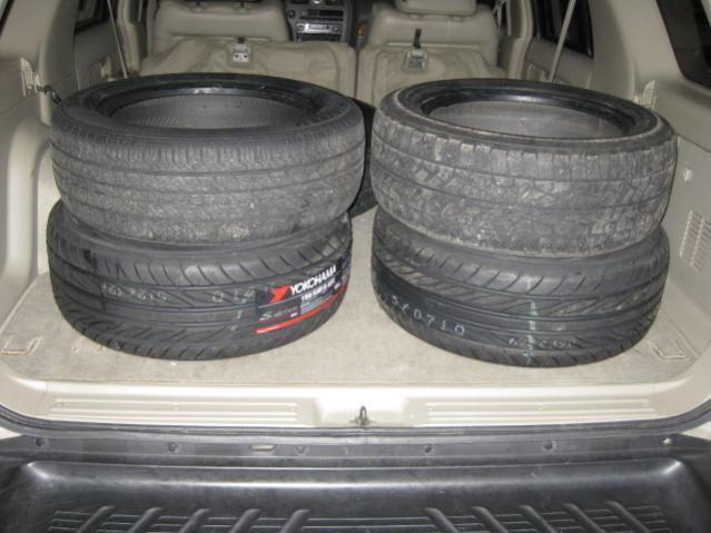

So i ran over somthing and got a flat yesterday. Decided to get 2 new tires not just one. I took the wheels off my car and took them to discount tire. There they slapped on some new Yokahama tires that i love. The guy there told me that one of my rims is bent. I have had tyhis su****ion for a while now seeing that i keep having to add air to this same tire every week. Because of a slow leek. So i'm sure that this slight bend in the rim is causing a slow leek in one of my tires. All the rest hold air fine. So my question is: can i get the rim fixed somehow . I mean the bent is soo minor i didn't even bother taking a picture of it. mainly because i can't find it. SO are rims repairable. Or would you guys just recommend getting a new rim? which option is smarter and cheaper? here are the new tires
