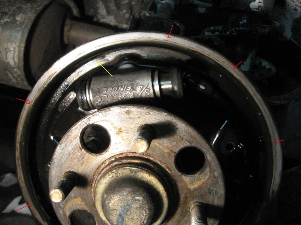

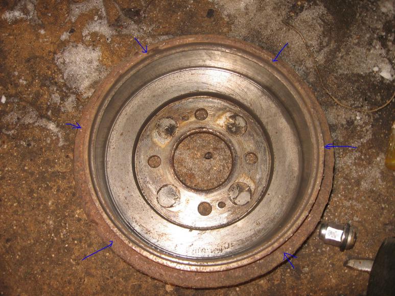

from photo, you can see the friction in the backing plate, which is pointed by red arrow. However, there is no friction in the drum part, see the part pointed by blue arrow in drum. where does this friction come from?

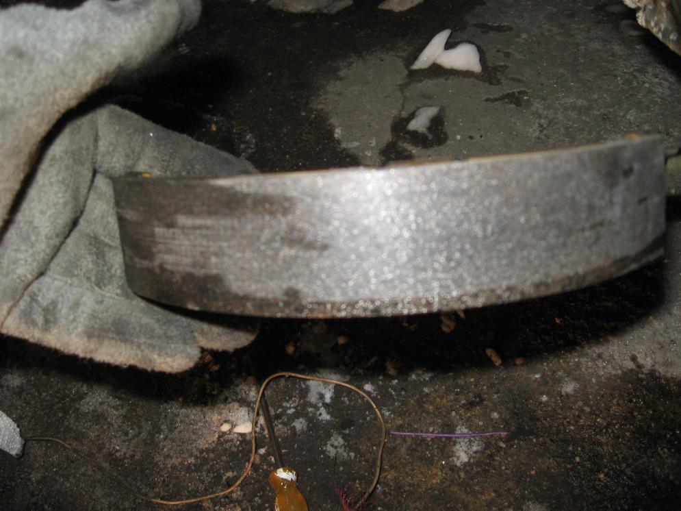

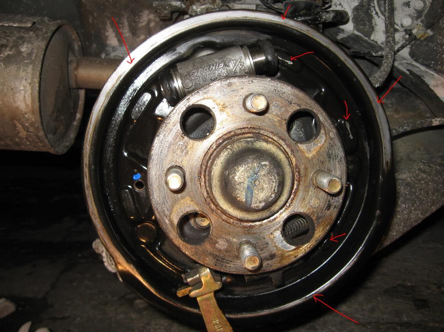

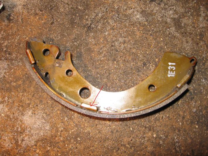

When brake is applied, there is grinding noise from this wheel. no this nosie when driving. Is it possible the brake shoe grinds on backing plate in other part?

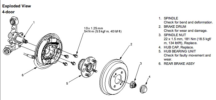

Striking the potholes may have damaged/bent the spindle. If so, you'll need to replace it.

If the spindle is bent, the drum will not align with the other parts. So you will have some unusual rubbing. It may not be real apparent just looking at the wheel, but eventually you would also get abnormal tire wear.

Only the shaft part is likely to bend. The brakes are attached to the cast part. So it will be out of line. You should be able to buy the whole thing (part #1) with the bearings, hub, and most of the brake parts still attached from a junkyard fairly cheap.
