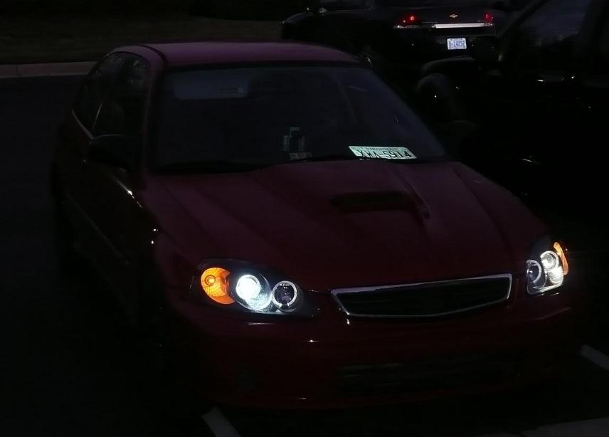

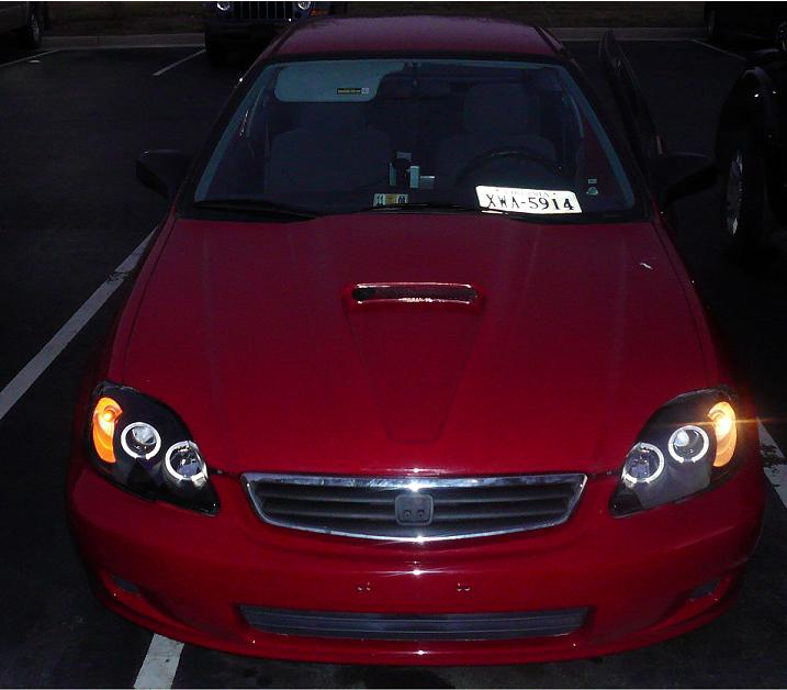

Rude, naw i just got the impression you figured i was lazy and wanted you to fix it for me. lol no hard feelings, ive been in those conversations before. But if you wait a couple minutes i will have some pics posted. No lines yet, still need to adjust them.
