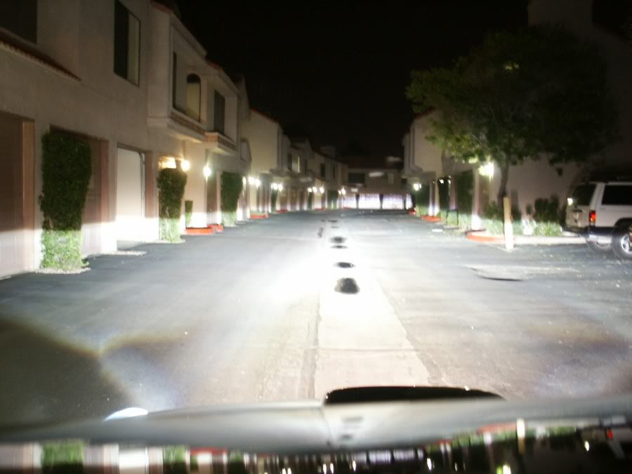

cause either way... unless ya retro fit some ACTUALY HID DESIGNED headlight housings youll never have that best spread out beam and sharp cut off point
these are my hids in nOEM housings

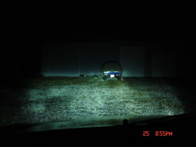

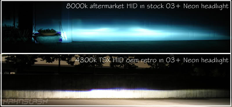

For a plug and play hit kit like Addiction and I currently have as you can see in the pic Addiction posted, there isn't even distribution of light and there are hot spots. as you can see in the pic here the top is your standard plug and play kit, which has the same pattern as a Halogen and can potentially blind oncomming traffic. With the bottom pic it is true HID retrofit, as you can see there is even distrobution of light and a sharp cut off line to prevent blinding oncomming traffic. the second pic you can see the even distrobution and cut off line alot better
