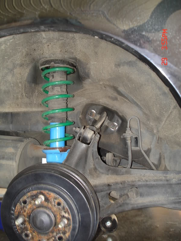

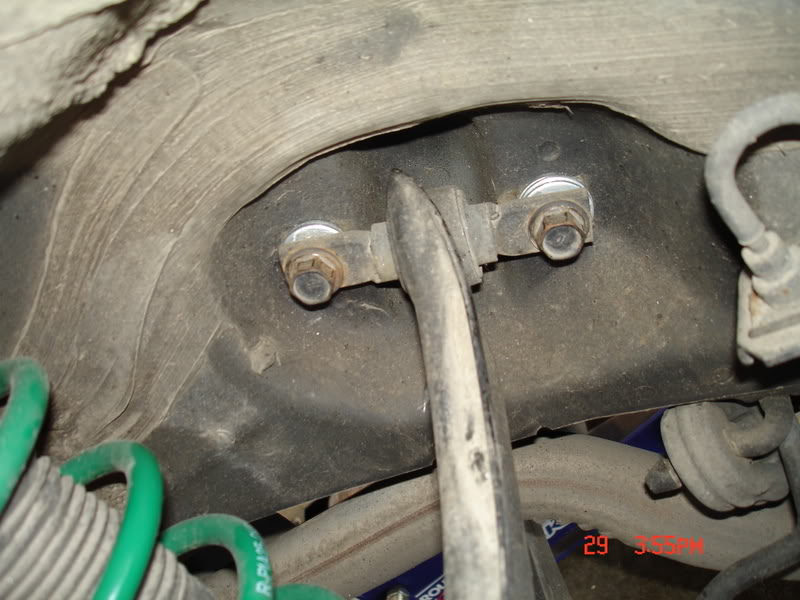

heres what you should try first....
2 bolts here... 3washers go behind
and then just the bolt that goes thru the lower strut...
once ya remove those 3 bolts YOU SHOULD BE ABLE TO JUST USE YOUR FOOT ON THE SPINDLE AND PUSH IT DOWN and with the two upper strut nuts off you should just be able to simply push the spindle down and pull the struts... out...
AWHOLE LOT EASIER than messen with those other LCA bolts that are so prone to seize up!!!!!
ive heard of TONS of people with nightmares about those LCA bolts siezing up... and if thiers a easy way around touching those its by removing that upper brace which should allow enough flex in the spindle to remove the struts. i wish i tried that before messing with my other side cause even tho the bolts did come out no problems... the threads for both bolts didnt look preaty at all! and i think the bolts where like 7-8bucks each..... but still worth it id say! ya just spent what? 160bucks for the springs... whats another 20bucks
just stick with ONLY buying the washers at the hardware store

so addiction you're saying dont remove the strut/LCA bolt, just remove the whole strut/LCA assembly, install the new spring and correct the camber all at one time wihtout having to remove the bolt that is so prone to seizing up?

no.... you HAVE to remove at least one bolt, there is no way around it
I'm assuming you have read this? https://www.hondacivicforum.com/m_225963/tm.htm
it's for a 92-95, but yours is basically the same.
see this, this bolt has to come out.
for the next step -- "wiggle the whole assembly out" -- it's easiest if you ALSO remove
- the inner LCA bolt at the subframe
OR
- the outer LCA bolt at the trailing arm / hub
OR
- the upper control arm in Addiction's picture, which you have to unbolt anyway for the "washer trick"
it just gives you more room to work and makes it easier for the whole assembly to come out

ya see thiers 3 bolts on the LCA the spindle bolt, the suspension bolt and the strut bolt... by just taking out that one MXS pictured and the upper arm 2 bolts that i pictured you can at least stay away from those other 2 LCA bolts... cause all 3 have been known to seize up... just cross your fingers and HOPE your strut bolt isnt!
i did my drivers side by just removing two of the LCA bolts and it was easier to get the struts in and out BUT with my passenger side i had both the inner and outter LCA bolts seized up BUT luckely before i started blasting heat and drills i went ahead and did the washer trick and SHOCKINGLY the assembly moved down alitle so i desided to put my foot down and tried to pull the strut out and it worked... WAY EASIER than heat and hours of drilling! LOL

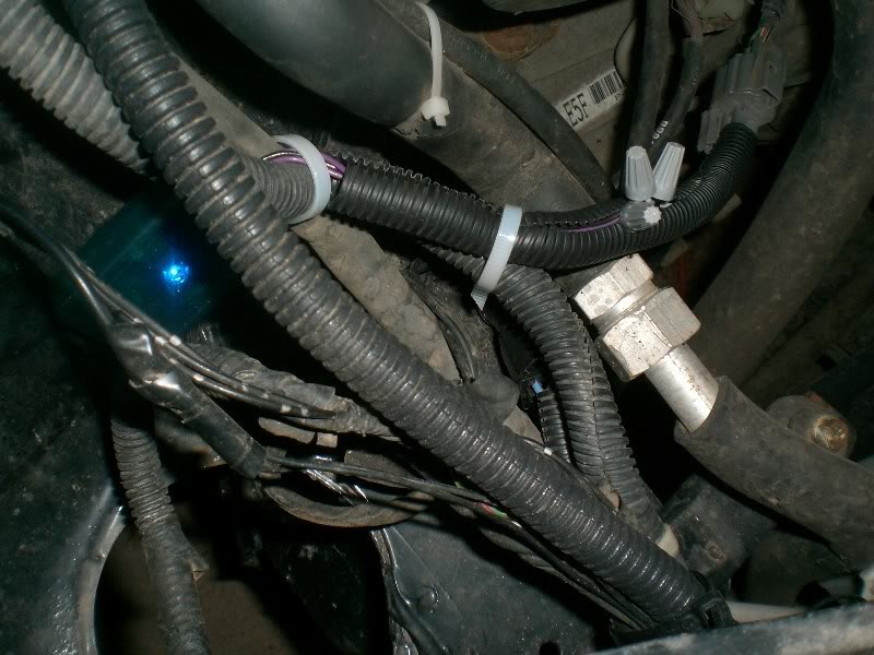

few pics, o2 simulator finally installed, got a CEL from something else though (sensor heater wire actaully)

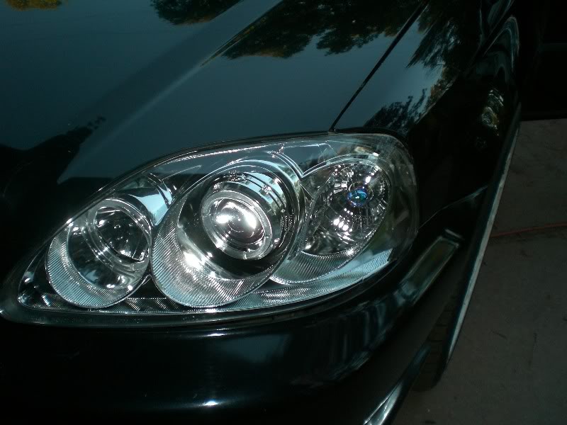

also, 2slo4u TOTALLY hooked me up with some blue turn signal bulbs that lightup amber, look great, that was really cool of him to do (he went out and bought them for me and shipped htem to me). Thanks alot man, heres what they look like
