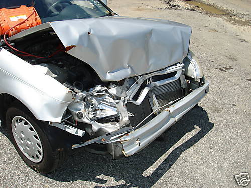

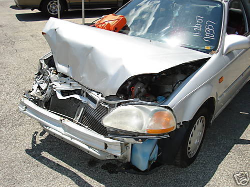

well first thing to do is pull the bumper cover off and post a picture up.
IMO from just the picture AS-IS no frame damage, just headlight and fender.
bumper cover looks like paint just flaked off.... hood minor dent on the corner, but from the looks of the paint already on the hood.... paints not that important to you
so just dont use pliers on the hood, simply use a hammer from the inside to slowly bend the curled under part from the bottom. and with the fender off and good fender and new headlight handy remove the old fender and with a hammer and dolly simply look at the passenger inner support looks and just do your best to make the drivers side match metal wise... your top headlight support brace will be tweaked of course so your headlight fitment might not be perfect so easily. but just spend some time with it... doesnt have to be perfect.... you can get some adjustment from the headlight itself if its verly off i would simply remove the headlight and just use a drill to open up the mounting holes alittle more so you can fine tune the headlight and then tighten it down in the perfect place.
main thing to get lined up is the fender which is quite easy really since the other 3/4 of the bolt holes wont be bent just the front corner since its so flimsy.
IMO a whole radiator support isnt worth it for such minor damage! its quite a bit of work removing it and then welding on a new one. and its held on the car by all spot welds. been there done that but mine was alot worse

EDIT.... o ya if your going to drive it like that DEFIANTLY go ahead and spend the money to get a wheel alignment just to be sure it didnt damage the suspension.... hopefully it will be fine BUT until you get the lasers slapped on the wheels and actually checked by the machine you wont know.... but if its fine youll at least know its not bent and your tires wont get chewed thru and be trashed so quickly! lets face it tires cost as much as a alignment. if its thrown off at least now you can fix it before it chews thru that tire and your stuck with alignment bill and new tire cost

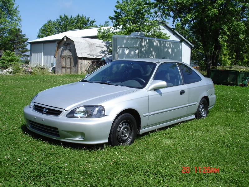

Sooo about two hours of work and it looks pretty good. It's a good temporary fix until i buy the stuff.
Another update. I headed to the junk yard today to find some parts. 50 bucks for a new fender, 50 for a hood, 50 for a bumper. so 150 for all. BUT my GOD there was only one 5th GEN civic and i swear i walked around that whole yard and it was pretty big. that civic was smashed, too. It's pickyourpart in Wilmington, Ca. So my question is, how should i go about getting the parts? Should i go the a honda dealer and pay whatever outrageous amount they ask? BUT should I ask my friend that works at honda to see how much? OR should i go to NAPA? Do they even have that? OR OR OR Should i go the other route and try ebay? Is it gonna be crap? haha so many questions. Any help is greatly appreciated. So here's the pic.
Oh yeah forgot to mention my left headlights wires were all gone so I pulled them out from the civic at the junkyard and got my headlight and parking light working again (yay no fix it ticket for me)
