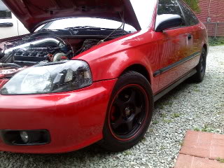

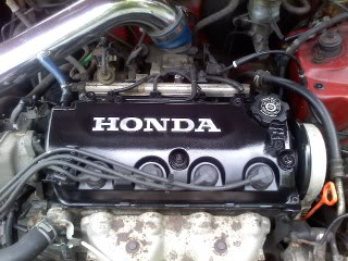

Finally finished it, doesn't look bad for someone like me doing it.

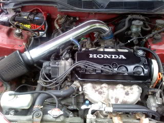

and 2 randoms I like:
Old Aug 18, 2010 | 09:34 AM
I like it. It reminds me of my old civic's VC
engine3.jpg?t=1282152577
