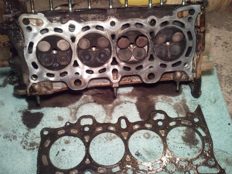

Here are some of the pics when I was replacing the head. The last picture is after I put everything back together. I noticed on the Throttle Body Intake hose it has a circle hole in the middle. I think it is closed off, but I look on another civic, and it has a square plastic box attached to it. Not sure what that is for as mine does not have it. I didn't take pictures of that though.
Attached Thumbnails Radiator Hoses very tight 95 civic ex-2012-03-14-19.56.10.jpg   Radiator Hoses very tight 95 civic ex-2012-03-14-23.46.06.jpg   Radiator Hoses very tight 95 civic ex-2012-03-15-00.34.54.jpg   Radiator Hoses very tight 95 civic ex-2012-03-11-16.41.38.jpg   Radiator Hoses very tight 95 civic ex-2012-03-15-04.11.47.jpg
