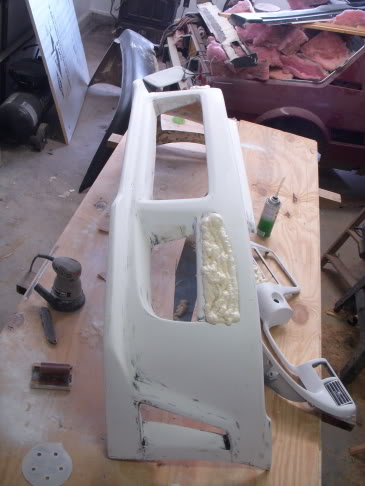

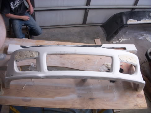

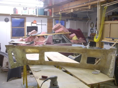

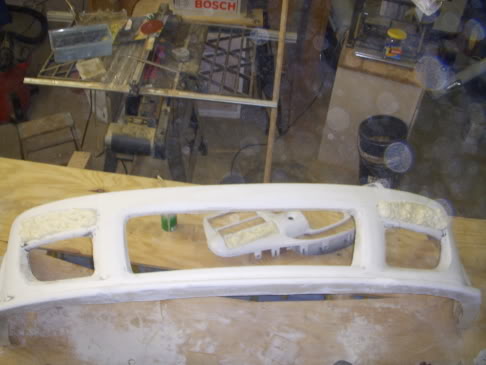

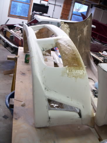

But anyway, here's some updates. I'm fixing the body kit and selling it (trust me, brandon... you'l love what I'm doing to it), so here's my progress on that. I finished foam-filling (for the most part) the front bumper, and started doing the fiberglass repair, along with starting to shave some two of the scoops to give it a cleaner look.

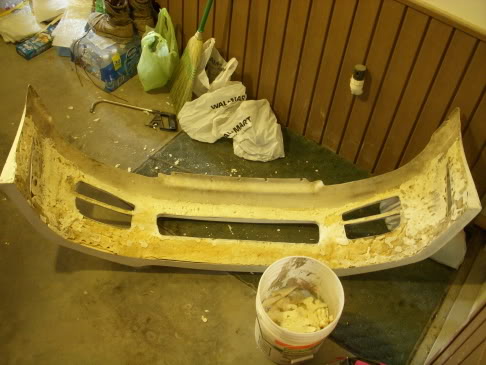

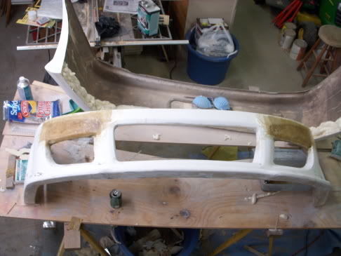

I finished filling the front bumper with expanding foam... it adds rigidity to the bumper, making a bit more solid than the flimsy 3/32" or so thick fiberglass the kit was originally made of. Filling the kit wasn't hard (spray the insulation, wait for it to expand and set up, lather, rinse, and repeat), but I'll tell you guys... getting it shaped right (basically flat) was a total pain in the ****. I normally wouldn't be this meticulous, but I want this to be done right (and show-worthy). I'll be fiberglassing over the back and painting it (well, primering anyway).
I got started on the fiberglass work... until I ran out of resin (I never mix enough lol)... I have another quart of it (which should be enough for the front bumper), but I didn't feel like opening it just yet... that's for tomorrow
Anyway, tomorrow I'm going to foam-fill the scoop I fiberglassed over and get it ready for fiberglass across the front of the scoop... also, I'll hopefully have a complete layer of fiberglass across the back of the bumper (I'm doing two layers of fiberglass and smoothing everything out with body filler before I primer it)... the way I figure it, I still need at least two more quarts of resin, two more cans of primer, and three more packs of fiberglass mat, as well as more cheap paint brushes... I'll be picking all that up tomorrow, friday, or saturday... whenever I get a chance to stop at the bank and take out more money lol

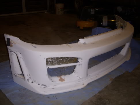

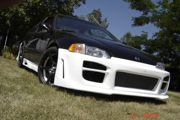

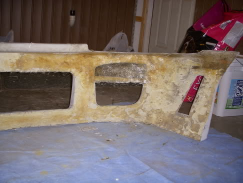

*edit: here's what the front bumper looked like before I started working on it:
And here's what it'll look like when I'm done:

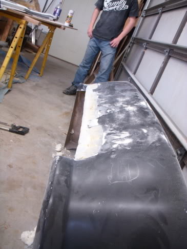

Same with the back bumper; here's how it was (dual exhaust outlets [:'(] ):

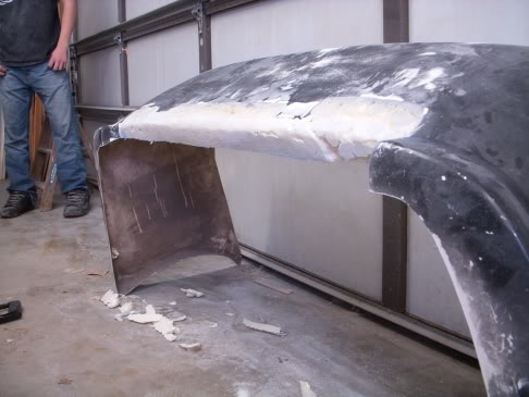

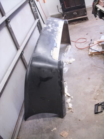

Anyway, I didn't get a chance to get on the computer yesterday, so here's what went on yesterday:
I got a good 85% of the back of the bumper fiberglassed, fixed the three cracks, and started foam-filling the scoops. I decided the back only needs one layer of fiberglass (especially since it's foam-filled), and I'm probably not bondo-ing the back of the bumper, mostly becuase I won't have time to do it (I have 7 days to finish the kit). But anyway, by tonight, the body kit should be 97% complete, meaning all I'll have to do tomorrow is primer it. Also, the side skirts will be done by tomorrow night, and primered by sunday. That'll just leave the back bumper for me to work on next week (and it's going to be a PITA to get the thing perfect).

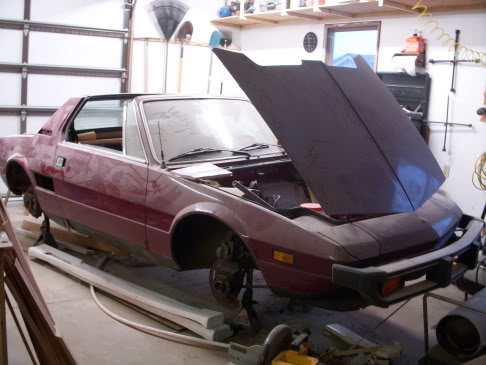

you recognized what it was? wow... that's amazing lol... me and my dad are in the process of restoring it... it's his old car
mid engine rwd ftmfw!
yeah... that'd be my dad... he was re-doing the insulation in the workshop and decided the fiat would make a nice bench to put all his stuff on lol

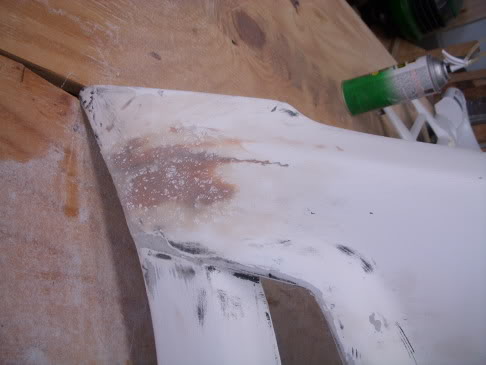

anyway, here's saturday's progress on the kit:

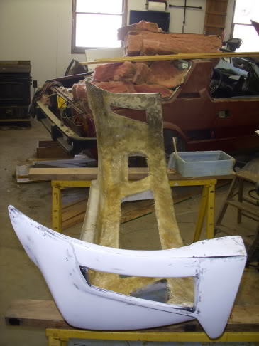

Trying to get the shape right for shaving the top scoops.... I want it to be as easy as possible when I go to fiberglass it.

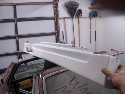

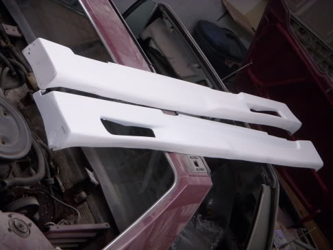

One skirt finished and primered... the other one just needs sanded down and primered.
The back bumper's not perfect yet, but that'll be taken care of after I fiberglass it.

The front bumper has been fiberglassed... now all I need to do is sand, bondo, sand some more, sand again, and primer [8D]
Both skirts are done (glad they're out of the way)

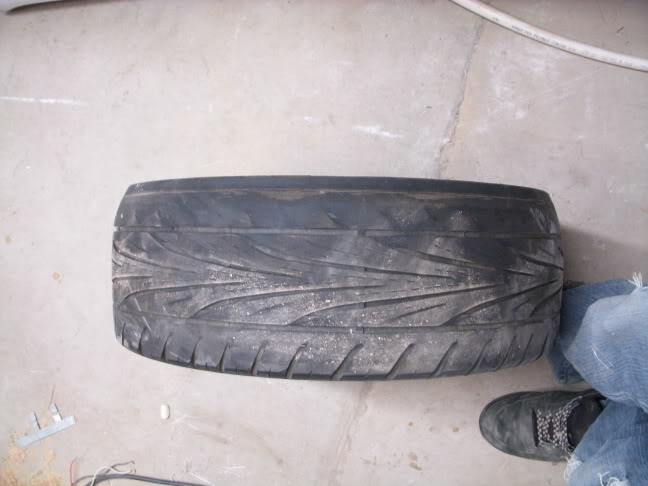

And here's why I need to get two new tires:
Don't see it? Look along the top edge. That's why you get an alignment

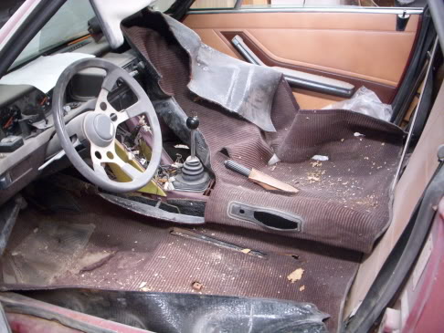

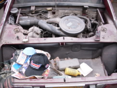

And since interest was shown, here's some pics of the fiat:
If anybody's wondering, I'm in the process of stripping the interior (the carpet needs replaced and the seats need repaired)... hopefully we'll be tearing the engine down in the next month.
