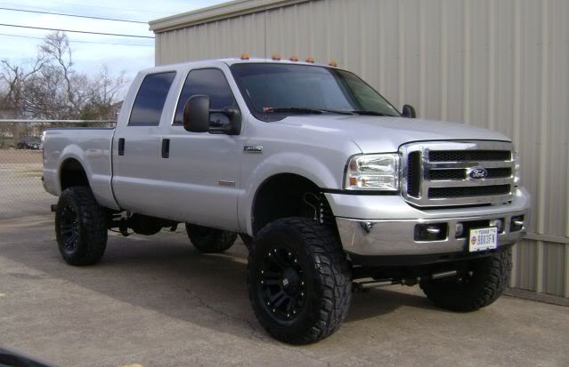

Most of my money in my car budget goes here:
That's a nice F350.
