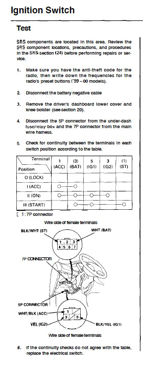

That would happen because the key switch was stuck in the "start" (III) position. When you push the clutch down the safety switch is pressed and the starter will come on and grind the gear. The starter energizes whenever the key is at III AND the clutch is pressed down.
