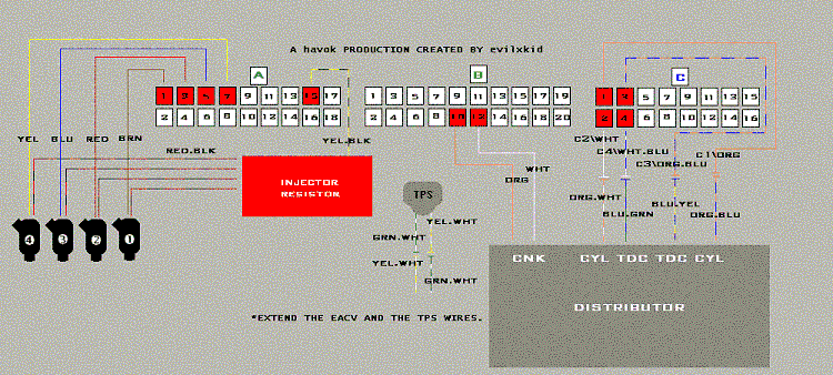

you wouldnt happe to no how to switch it to a 4 injector setup?
Old Apr 26, 2010 | 10:50 AM
i would its called the dpfi to the mpfi, ive done this to my 91 ef hatch.
you will need to find a 88-91 civic or crx with the mpfi, you will need.
pm6 ecu
complete throttle body with injectors
distributor
fuel line from filter to fuel rail
and some extra wire
and ecu pins (wires that come out of ecu plugs)
