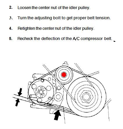

i hope i can afford all 3 belts. lol. which ones the idler pulley? is that the pulley that's kinda by itself, and not on the alternator, compressor, or PS pump?

do you have an online shop manual for your car? You can download it for free, it'll be easier to tell from the diagram. I want to say yes that's the one, but don't want a misinterpretation to end with something bad lol.

The idler puller is used for adjusting the A/C belt tension. You need to loosen the center pulley bolt prior to adjusting belt tension. Then tighten the center bolt when finished with the adjustment.
Old Aug 2, 2008 | 02:42 PM
yea, so it must be that one pulley that's all by itself and is the 3rd pulley wheel in the a/c pulley system?

The idler pulley has a red dot in the middle:
Old Aug 2, 2008 | 02:53 PM

i don't know if i'll be using the manual much anyway. i've changed the timing belt on my old civic and i know pretty much what to do since you gotta remove all that stuff to get to it. i'll just refer to the manual to make sure i don't forget anything. i just didn't know which pulley was the idler pulley
