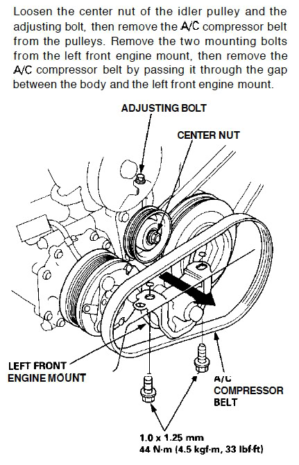

thanks for that info RonJ, it would have taken me a while to figure out how to get that one on there. lol. So turns out, that motor mount is broken on my car? WTF. The rubber has basically deteriorated and cracked off around the bolt that goes through it. I got the compressor and belts on tonight. It sure is a pain trying to get the alternator belt up to the right tension without someone helping you hold it in place nice and tight.

If you think the bad front left motor mount will cause some annoying engine vibration, then just replace it. The equivalent mount for my 97 Civic costs about $50 at Majestic.

i'm not really that concerned about the motor mount unless you think i should be concerned.
is that motor mount even really that important?? theres the one already right next to the timing belt, it seems like that would be enough. idk

With respect to the mount, don't worry about it unless you begin to notice increased engine vibration.
