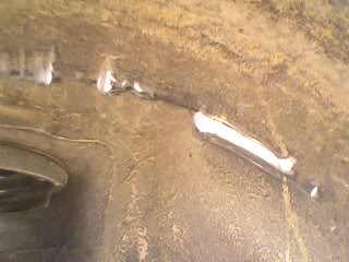

my rear suspension is now officially broke..lol

better explanation on brokeness?

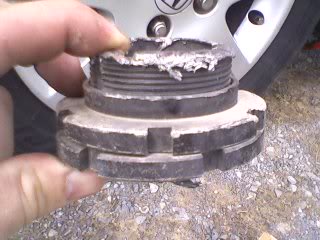

well heres what was left off my coilover sleeve that i found.

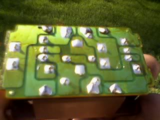

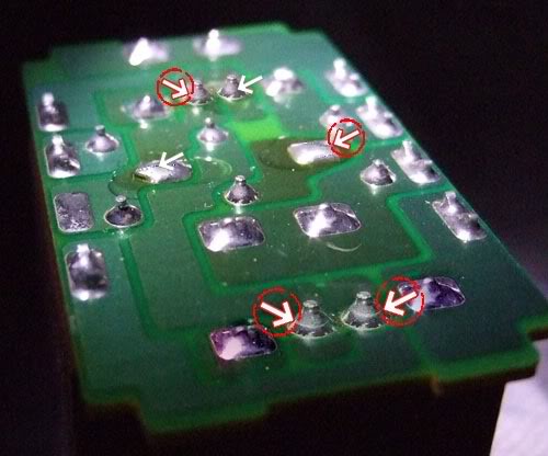

ok so ive been having problems with the car once in a great while not wanting to start.
so i figured today ill pull the main relay and check the solder points. well after hunting for it for about 25 mins under dash i finally found it. it isnt in the same place as a civic.
and once i pulled it off and brought it inside the house and with a good light i was shocked at how many connections were bad(cracked).
found it!
bad spots.
fixed.
so far i havent had any problems what so ever.

nice fix
and damn the previous owner really f'ed some stuff up
