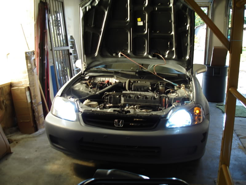

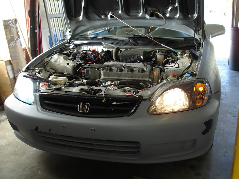

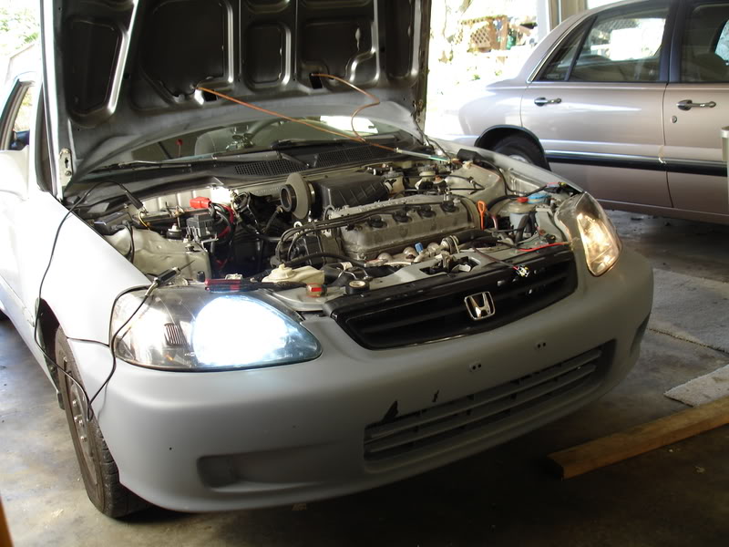

well they are all bixenon. they all have the built in magnet and tiny wiring on them.
i sent him a email and see what he says.... i dont think it will be a huge issue because the headlights do have a front cone kinda so it shouldnt make a big difference....
and right now im just waiting for the sun to go down now to get some nite shots and adjust them better. so far im pretty happy with them. tho i do hate the headlights.LOL i need to buy some oem black style headlights, seal them up and slap them on the 99 civic and put those chrome oem style headlights on this 96dx civic.
i have to eventualy slap the second set onto the 99 pretty soon as well! it just has standard hids with the weak @ss halogen high beam.

first video left stock. right HID
second video with both HID
sure not as good as a cool retro fit BUT the price is right at only about 60bucks per kit.
and on a side note its almost dark out

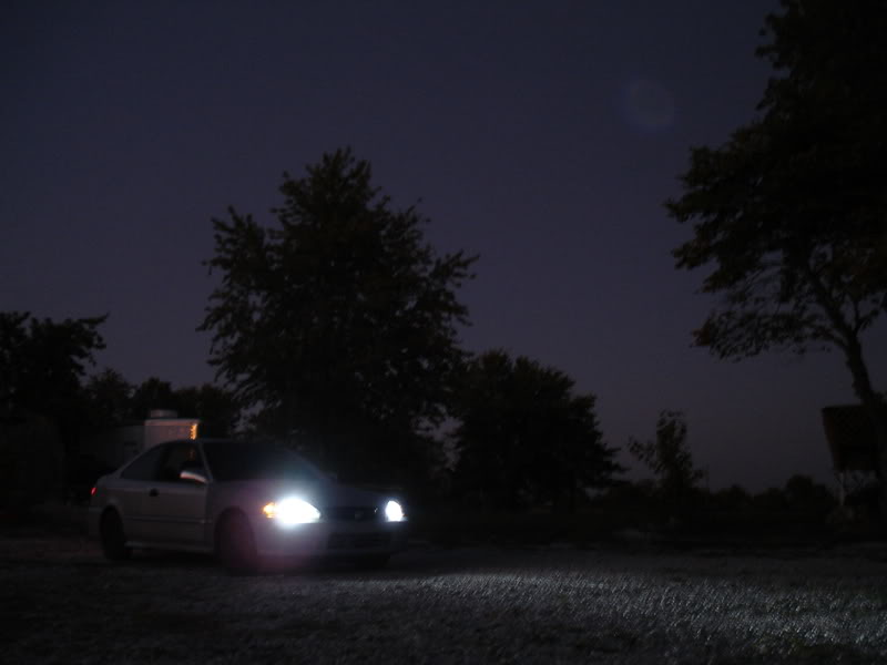

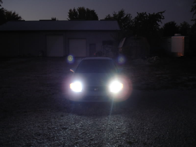

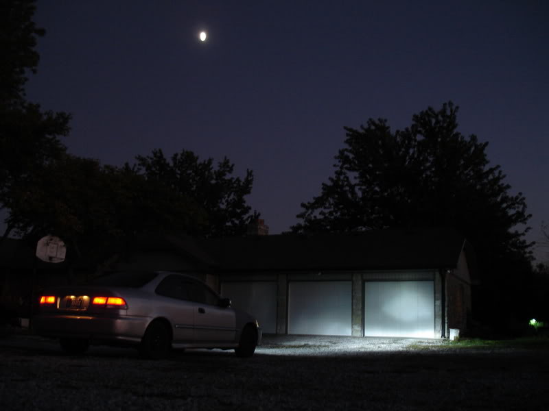

YEAH... its dark well close enough
LOL
LOL i used my fingers to give the super long tongue look. LMFAO

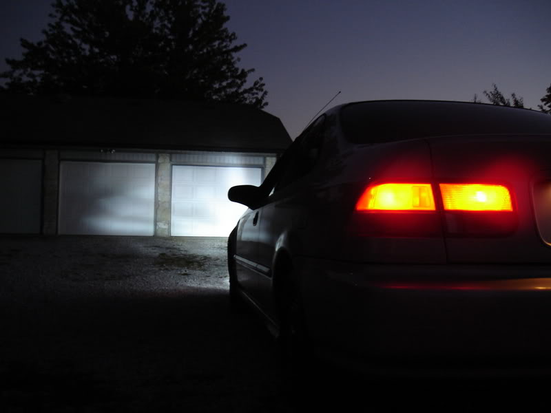

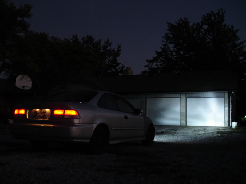

LOWs

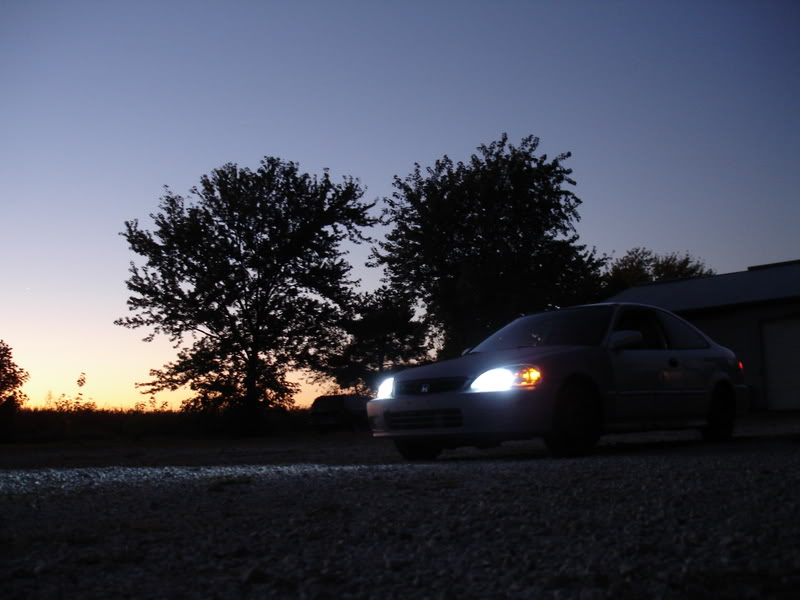

HITHs
and another video, click to play...

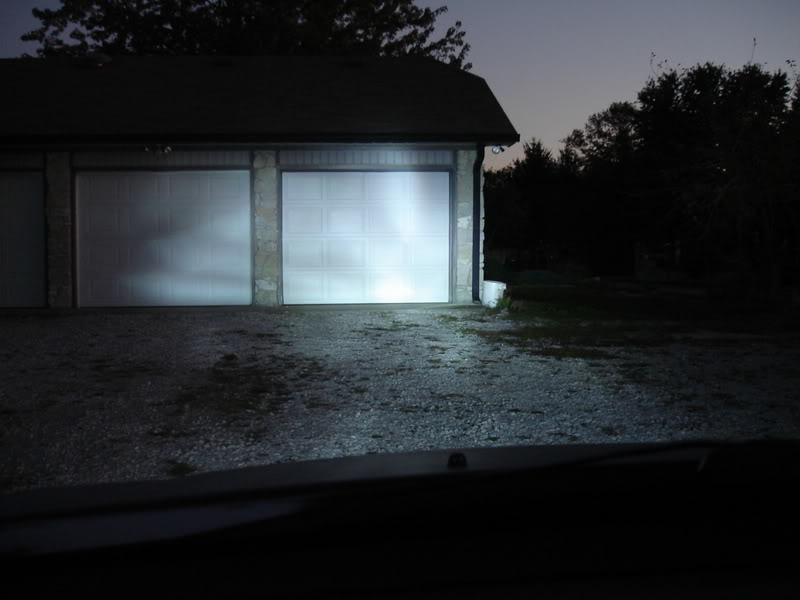

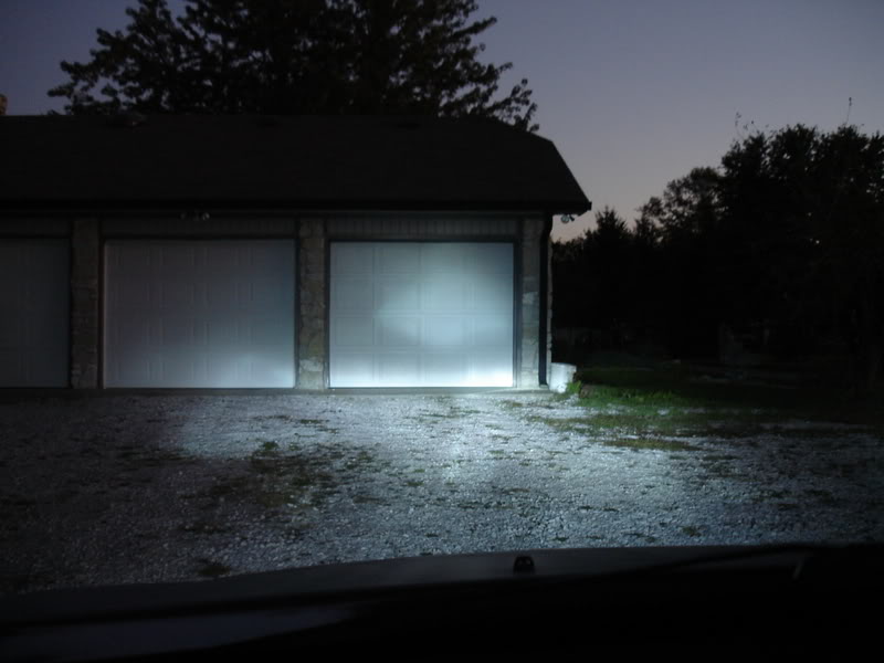

i do need to adjust the headlights alittle but i dont feel like it right now since the shop is already closed up. ill pull my car in the barn tomorrow night and tweek the aim alittle bit. just easier to aim on a flat wall.
so far just playing with them I LOVE THEM!

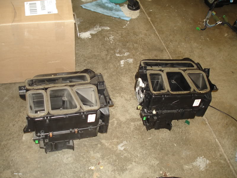

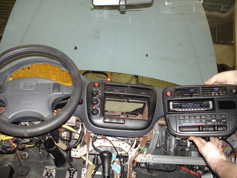

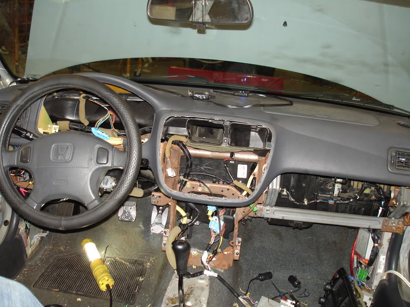

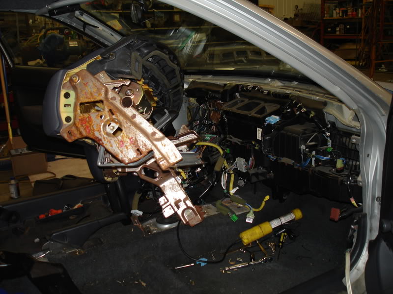

ok well today i got my 96system removed. tho afew wires on the dash that are being a PITA so i couldnt fully remove the dash to do all the work. mainly wires from my alarm system... but o well. still enough room to get what needed to be done for 1 afternoon.

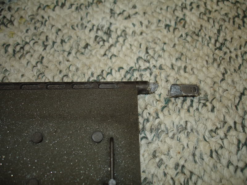

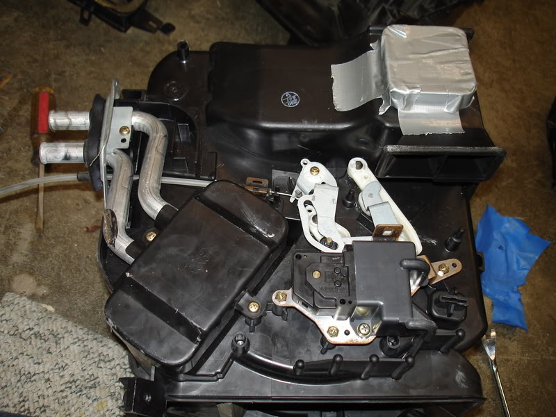

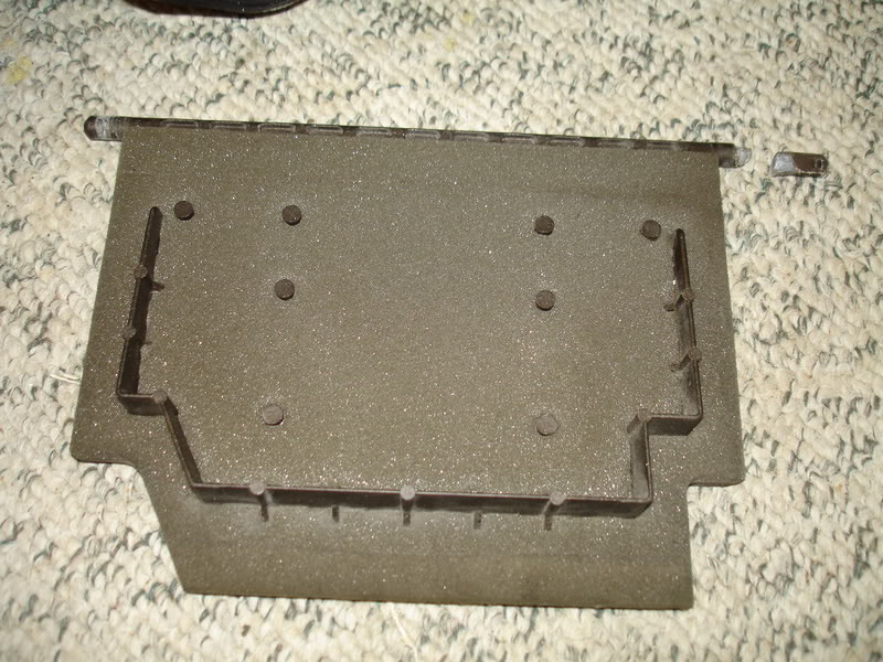

and my repair that i THOUGHT would be good on the new heater box was not good after all.... good thing i checked before i slapped it all in!!!!!! luckely my old 96 box uses the same components for the most part... so i was able to pull the 2 boxes apart and just swap out the flapper that broke.... unfortunately when i removed the 99s air controls i didnt know there was a bolt on the back side/firewall engine compartment that holds the box inplace from the rear and i busted it off unfortunately.
tomorrow ill try to cut off my good mount section and try to glue it to the new box. hopefully it will be enough for a firm mount...
and thats the flap that goes over the heater core so if i didnt fix it could really screw up the heater/ac features!

got the old flapper inplace and everything screwed back together ready to go in.

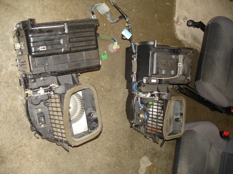

and yes duct taped BUT thats because the 99 i got it from was a 4door that had air vents ran down the bottom that flow to the back under the seats. mines a coupe so i dont need lower rear air... so i slapped some duct tape over it and put that solid flap inplace and then duct taped it again to hopefully keep it inplace.... if it ever falls off then ill glue that sucker solid. but not right now my back is killen me from contorting my body so much.LOL

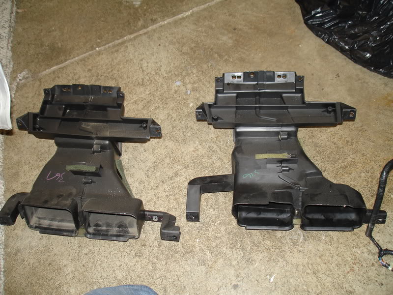

they look so similar but o so different ; )

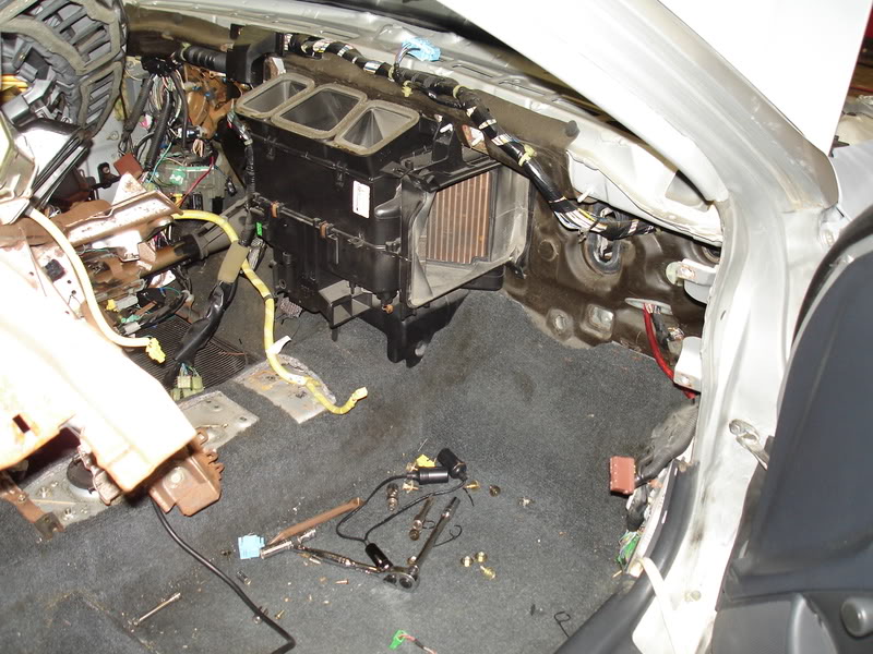

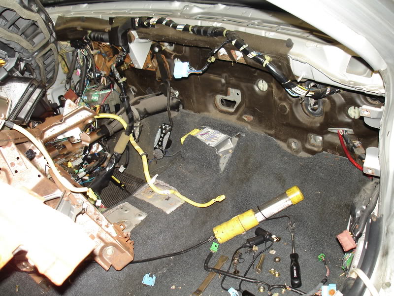

now ive got it all torn out...

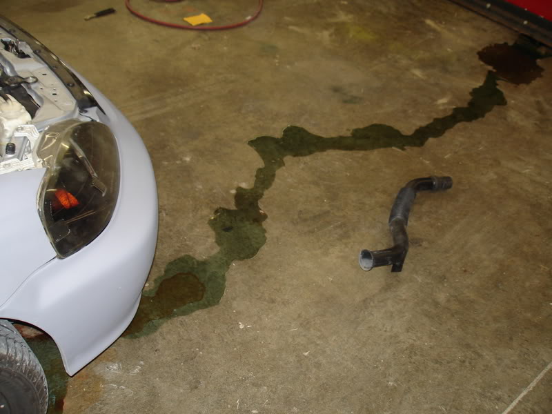

and my baby is bleeding its blue life blood

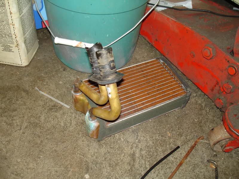

i think my old heater core was leaking so im using the 99 one...

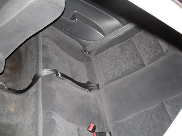

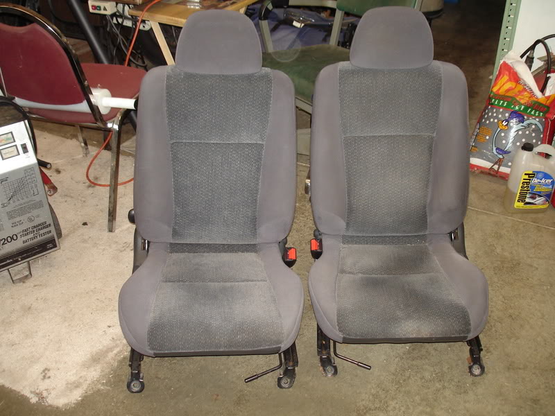

im also replacing the stock seats with those 99 seats... now i just need to look out for a rear matching seat..... anyone need some 96-98 seats
i like the ex seats alot more... mainly due to the passenger seat that slides forwards when the back is tilted forwards... plus theres a thicker bar under the seats that my guns hooks onto alot better!
anyone have some ex rear seats for a coupe?
i need this style....

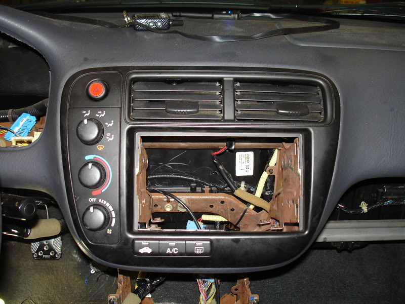

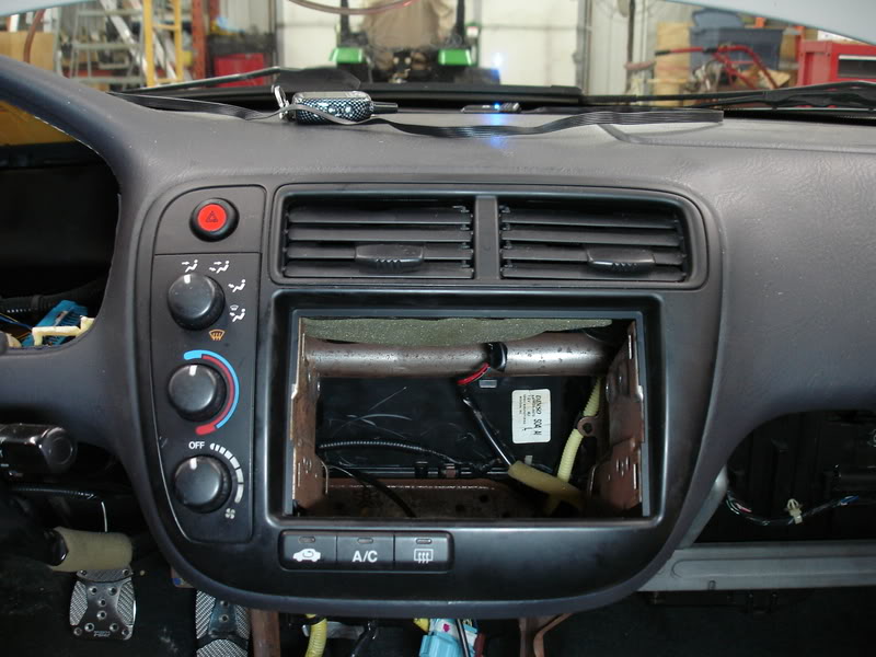

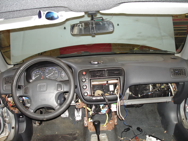

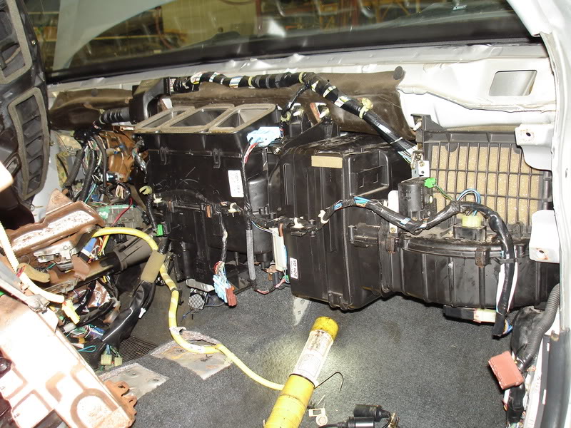

OK DAY 2... i have the new unit installed now. have the dash put back in MOSTLY.
everything works good so far BUT the dealership didnt have those heater hoses instock so they had to order them..... HOPEFULLY they will come in tomorrow and ill finish everything....
only downfall is the bottom mounts for the 99-00 controls dont bolt up to anything... im not sure if theres a brace i could just buy so it bolts up.... ill compare them when i pull my radio out of my 99ex to swap the radio into the 96dx if the guts look the same and the brace is interchangable then ill go back to the pullapart and buy the brace. BUT if not ill just use some heavy duty zip ties and use them to hold the metal bracing tight against the metal skeleton! it will hold it just fine im sure! but ill find out tomorrow when i swap the radios.

LOOKS SO MUCH BETTER!!!!!!

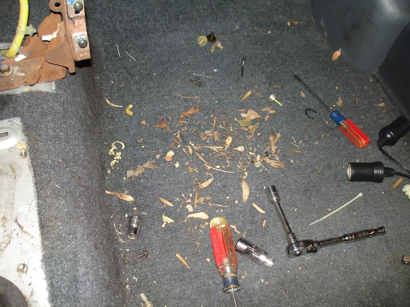

and if you ever drop your air box.... be sure to clean out the debri before installing the unit!!!! mine had TONS of debri in it..... im glad i cleaned it out otherwise it would have been alot of odd noises with the blower turned ON! and no one likes rattling leaves sounds when you turn the air on! LOL
so far so good! i just need to get the new heater hoses so i can finish it up HOPEFULLY TOMORROW.
i think i found out how to wire the defroster... i just havent tried it yet.
