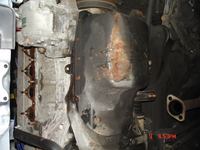

Addiction - I am keeping the y7 pan as mine is leaking. I replaced the gasket, but no dice. It still leaks. So I will use the pan with another new gasket and hope it works.

if its leaking just use some honda bond on it... when i did my 94civics oil pan i covered the whole gasket top and bottom with the honda bond before i put it on. sealed great. most likely your pan is just slightly bent on the flanges and really a simply wooden block and hammer could straighten it out perfectly. but the honda bond or other sealer on the gasket should be enough.

Addiction, I'll end up using honda-bond on the new as well. I have no problem selling you my y8 pan if you want it. You'll just have to give me some time to remove it and all. Hopefully I will be doing that with my next oil change (soon). I'll PM you when I get all of this situated.
Yes, the only difference between the y7 and y8 is that the y7 is steel, and the y8 is aluminum.
