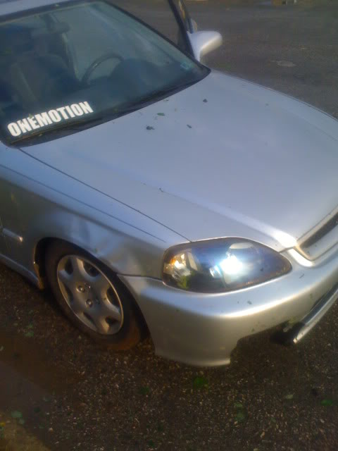

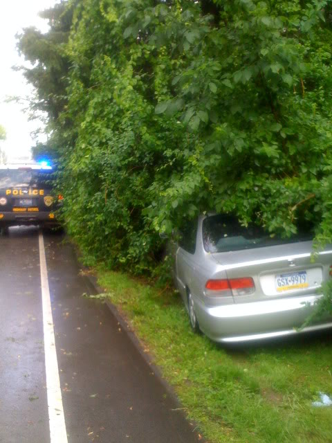

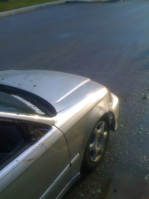

Story: While driving up to Bucks County (about a hour away) to pick a few random parts for the Civic, it started to rain. No big deal. I got off the highway, as my GPS instructed me to, and continued down a road following a mini-van. It's begins to pour, and then hail..maybe like the size of nickels or so, then everyone in the front of me slams on their brakes. I hit the brakes, and moved away from hitting the back of the van.
I ended up destroying about 5 little bushes and running into the big bush you see in the pic. Since it was raining, I couldn't get traction in order to back out. Cops came and had a tow truck pull me out (which cost $115....ugh.. hopefully, insurance will take care of some of that.) Here's some more pics of the damage. They are from my cell phone, so the quality may not be the best.

All in all, I need at least a new front bumper, pass. fender, and pass. side mirror. I drove it home without any problems, and the alignment wasn't off at all (that I could tell). I will be taking it into my buddy's shop tomorrow or Wednesday where I have a lifetime alignment plan, and he'll double check the whole suspension to make sure everything is fine. Until then, I won't be driving at all.

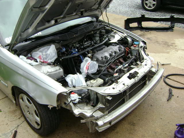

I got a lot of work done with the car yesterday. I remove the entire front end of the car, cleaned all the dirt out with simple green, and put everything back together. I only had to use a total 3 washers in order to get everything looking straight. Here's a pic of most everything removed and bagged.

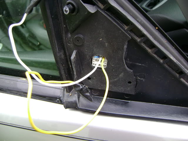

Here is a pic of the remaining plastic on the door

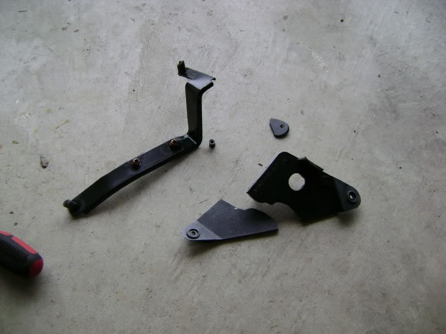

I removed all the plastic off the mirror and off the door. I then grabbed my fog light bracket and decided to use this to help keep the plastic together.

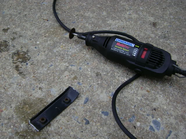

Here's one of the fabricated pieces I made from the bracket. The other one is the same, but a little shorter. (Dremel FTW!)

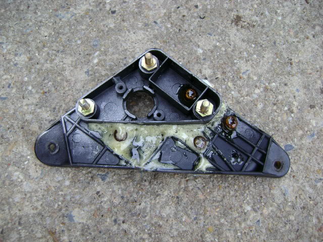

Once I was done making those two pieces, I then drilled holes in the plastic piece (that holds the mirror to the door) and attached the brackets with screws. I also used some gorilla glue to make sure nothing would move whatsoever.... I am still trying to pick the gorilla glue off of my fingers.

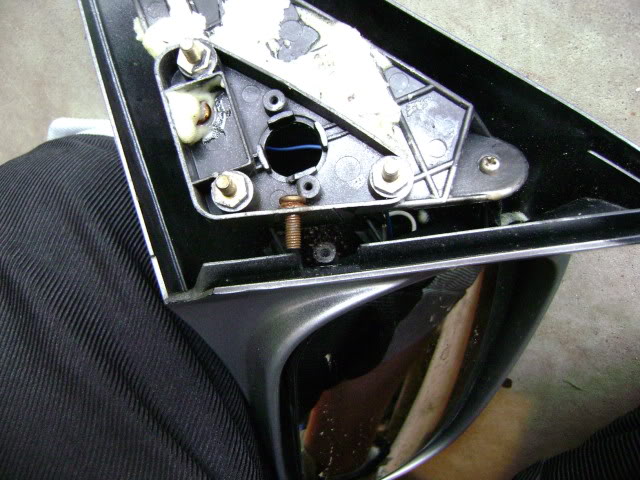

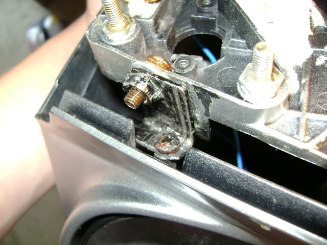

Here was my last problem regarding the mirror... (don't mind the brown screw, I decided to take this pic after it was fixed)
Without that being connected, the mirror was only being held on by two screws, and would wobble up and down a little bit. Definitely not good because the next time I go 80mph on a highway, I don't want to worry about the mirror breaking and flying off. So I needed one more metal bracket that had like a 115 degree angle. This is what I created.
