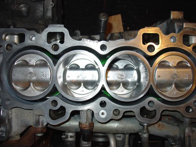

I pulled the head off last night and had a look inside. It looks like the #3 and #4 had more carbon build up then #1 and #2. I also noticed a lot of hard carbon deposits on the exhaust valves. The only reason I took the head off was to make sure the internals were in good shape before dropping it into the car. Better safe then sorry...
I need to find a honest shop in the Los Angeles area to inspect and mill the head before I put it back on. Anyone know of any?
Since this is my first real motor build I was wondering what you all think based on the pictures. Does anyone see anything obviously wrong that I am missing due to my ignorance?

See the heavy carbon deposits on the #4 exhaust valve? Does that indicate a problem? The rest of the valves seem to have similar levels of deposits. Uniformity in mechanical components is normally a good thing. Is there a safe way to clean that junk off there?
