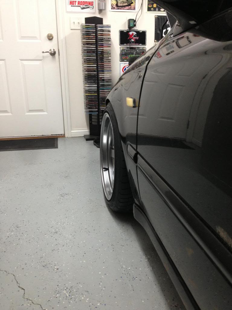

put on the rear camber kit not too long ago, got my tires and decided to mount just one wheel for now to test fit. they poked out a bit more than i expected so i decided to pull the fenders out a bit to accommodate the space. the fronts worked like a charm, but i ended up stripping the threads on my fender roller trying to pull the rears out oh well, atleast my car is done and i managed to make a little $$$ rolling fenders for buddies of mine haha
i also had to grind down part of the brake caliper brace a wee bit for the wheels to clear.
here is a general idea of what it looks like with the wheel on. for those who are interested, they are Nitto Neogen 205/40/16 tires stretched on a 16x8 et20 wheel.
i like the look of pulled fenders. it reminds me of old school wide body kits, without actually having a wide body kit
