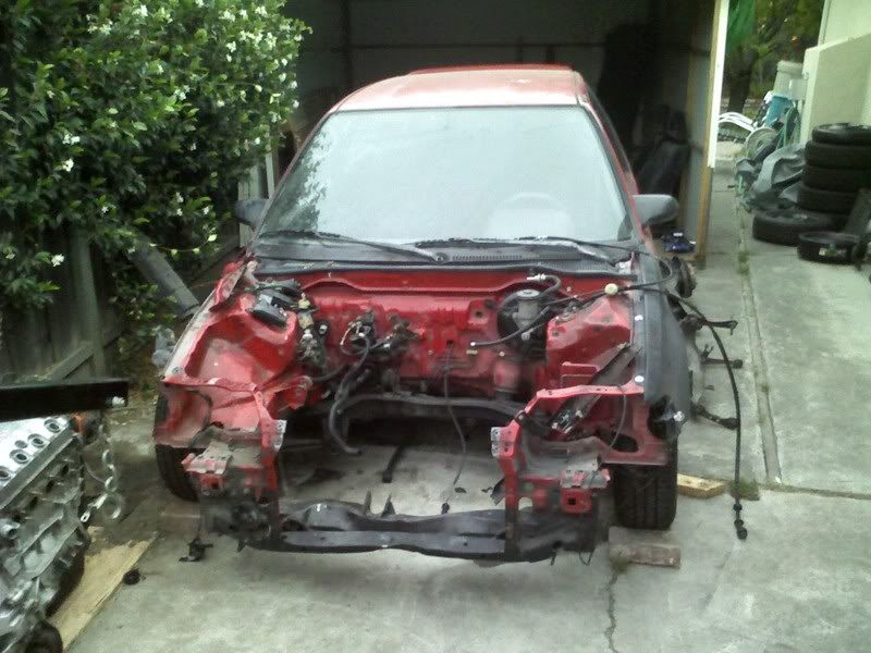

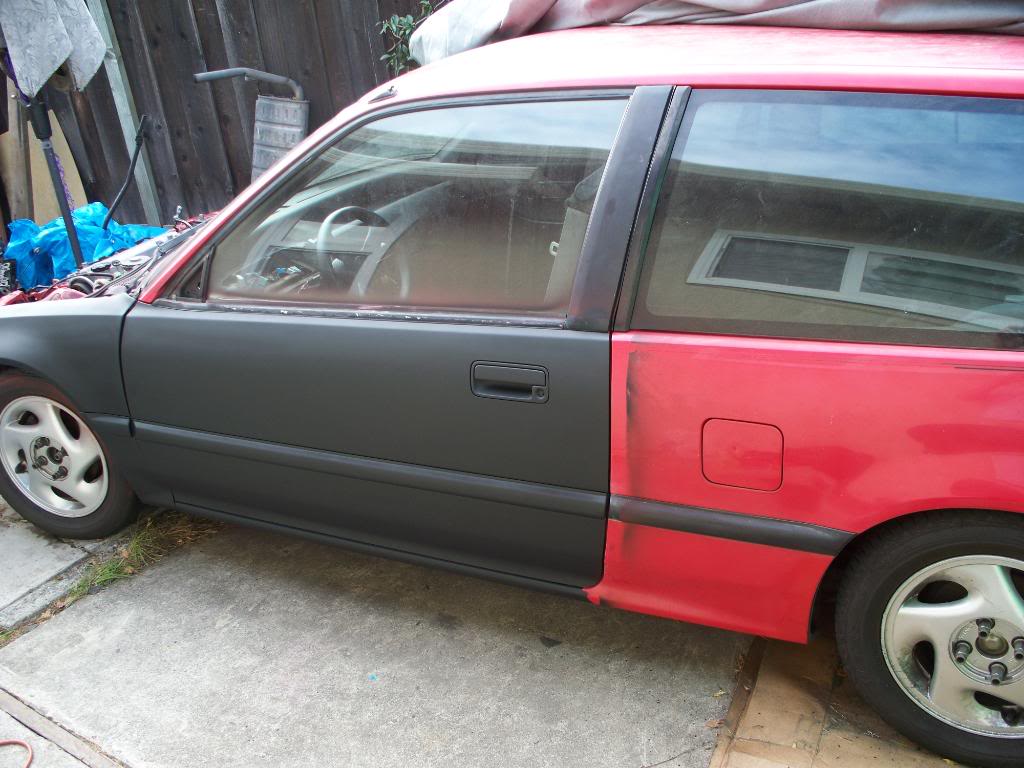

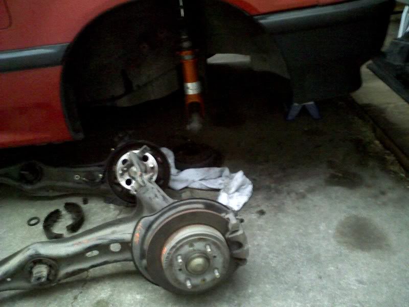

Alright so I finally decided that I would restart a project thread for my ef. For my ef I want it to be fast but also look good. For the look of the car I want it completely flatt black with red accents(the original color was red it'll be easier) and a pretty stock look on the outside besides the paint obviously. Brakes I now have rear discs. Suspension it has ksport coilovers. For the interior I want red sparco or bride seats. It already has a momo steering wheel and I plan to have rear seats but also a 6-8 point roll-cage. The original plan was to turbo the d16y7 but I decided to start over with a b series. So b18a is a go. My current plan is for a built b18a for all motor and nitrous. I haven't really decided on a hp goal yet. But with a built motor and direct shot of nos I'm expecting 250hp. That might be a stretch but we'll see. Ill try to keep this updated as much as possible but probably for the next couple weeks going away.
If anyone has advise on what parts to use feel free to let me know.
Right now I have:
Almost everything.
My lower end.

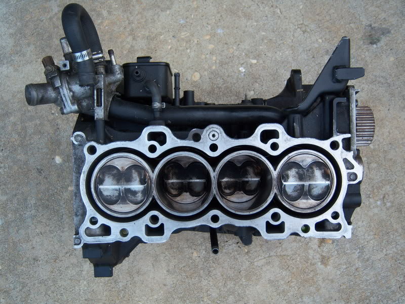

b18a1 built block with type r water, and oil pump. it has a lightened crank which is balanced, and its been bored out to 82mm with 12.7:1 JE pistons; it also has eagle rods, ACL bearings, and has been blue printed. the block has less then 500 miles on it
I need to buy:
Throttle body
header
traction bar
What I want:
New seats
New windshield
headunit

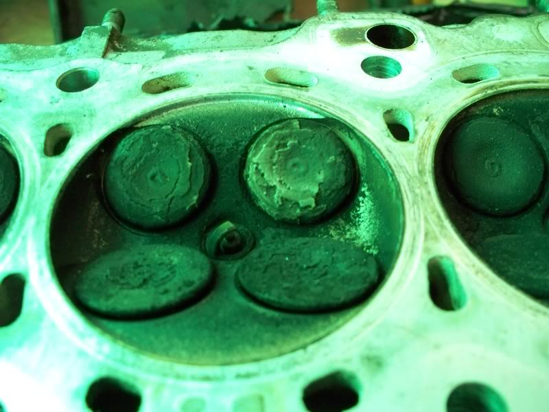

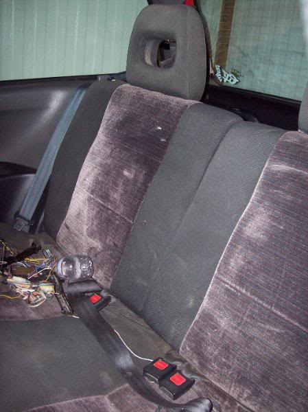

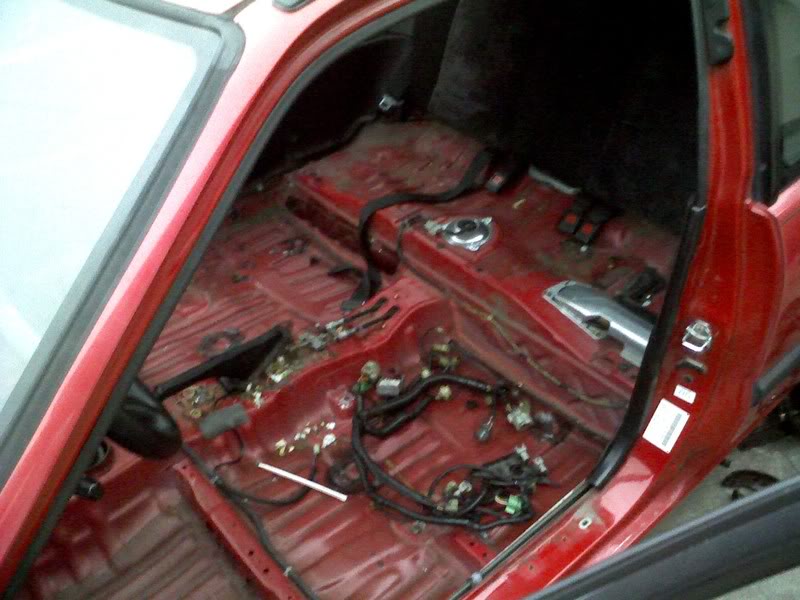

So heres what everyone wants PICTURES.

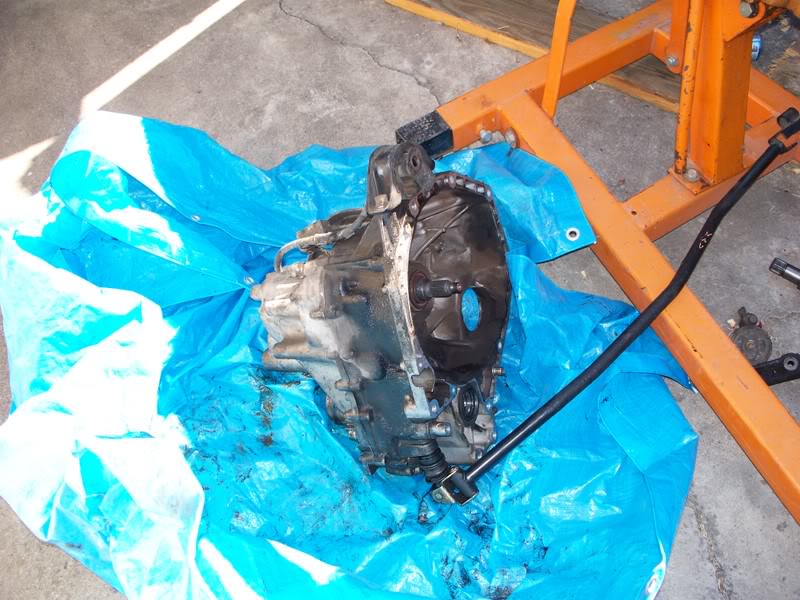

Old Aug 6, 2008 | 02:50 AM
GReddy_Civic's Avatar
Snail'n Admin
Posts: 3,040
From: Don't worry about it
Awesome bro. It looks good. Just one question, what trans is it from? Is it a b16a or b18c trans? I know the ls trannies die at the higher end.
Old Aug 6, 2008 | 09:29 AM
jpnolan's Avatar
Posts: 1,833
From: Miami, Florida
well **** i didn't know that its a ls trans. higher end meaning rpm/milage/hp?

Mmmmm bitches more pictures. I got head.

I dont know if its an ls trans. It was more of a question to you if you know what it is, because id like to know
