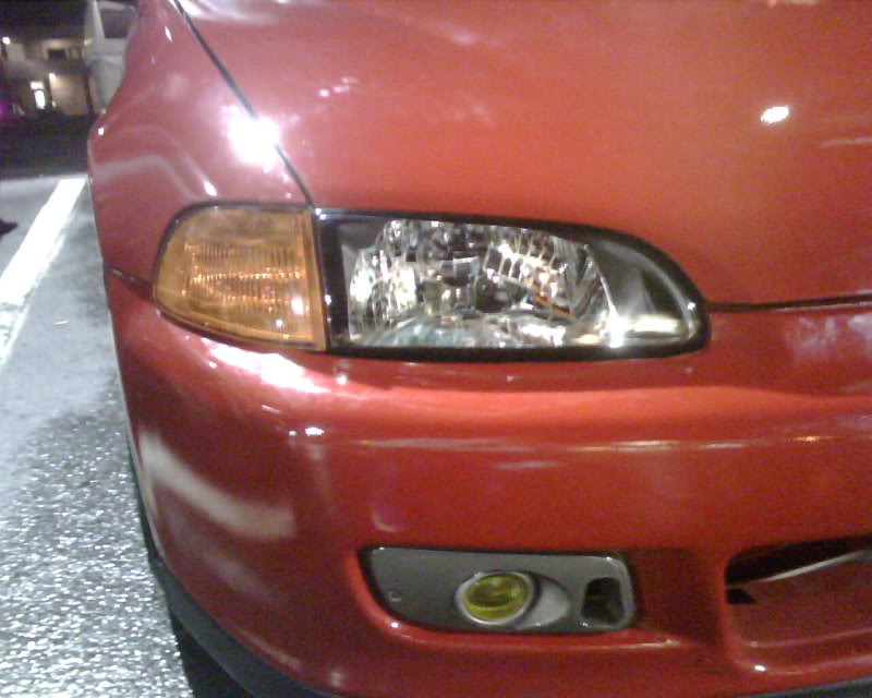

Update: So I got the black housing headlights today and installed them in about 30 min after work. I took a picture and totally spaced taking a picture of the car since its been lowered. Gonna have to take care of that tomorrow. Waiting on other parts in the next couple days.
