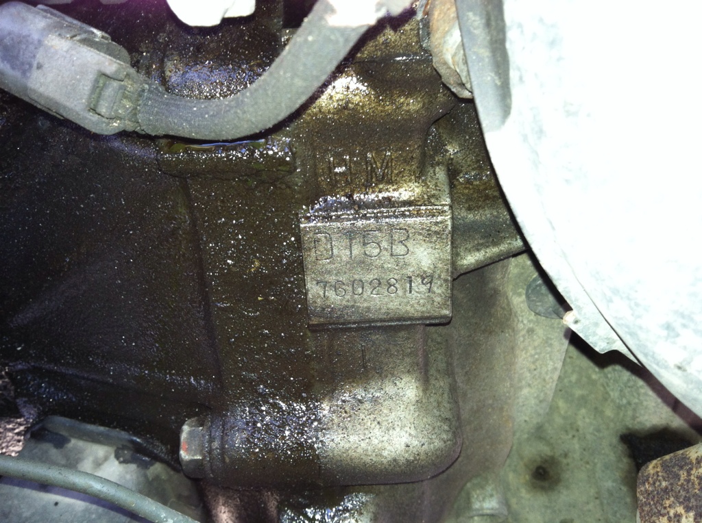

I must have missed the second solenoid if he has two then. OP, look behind the passenger corner of the of the head. Google vtec solenoid to see what and where it is exactly. Engine code is stamped on the block next to the transmission and should be easily seen when standing in front of the vehicle.

I only see one niod unless the other is somewhere else. Would both be next to each other?
It says: D15B 7602819
What does that number mean? Also I was told that the oil leak is from an oring in the dissy, anyone know the part number so I can go get one today or do I just tell them its the dis oring for a D15B vtec e?

Well if he did reuse the stock head of a d16z6 than consider yourself lucky!!! That valve cover is from the crappy version of the d15b. There were two - one equipped with dual stage VTEC-E and the pretty nice one closer to the z6 and b 16 at the same time. If all you have is the valve cover of a vtec-e machine - tap yourself on the shoulder and get a beer. If you only have one solenoid you probably do have a z6 head and the p28 would be correct. To see if VTEC engages you really should just run a light to the dash to indicate that it engaged. There's a lot of DIYs on the web on how to do that.
