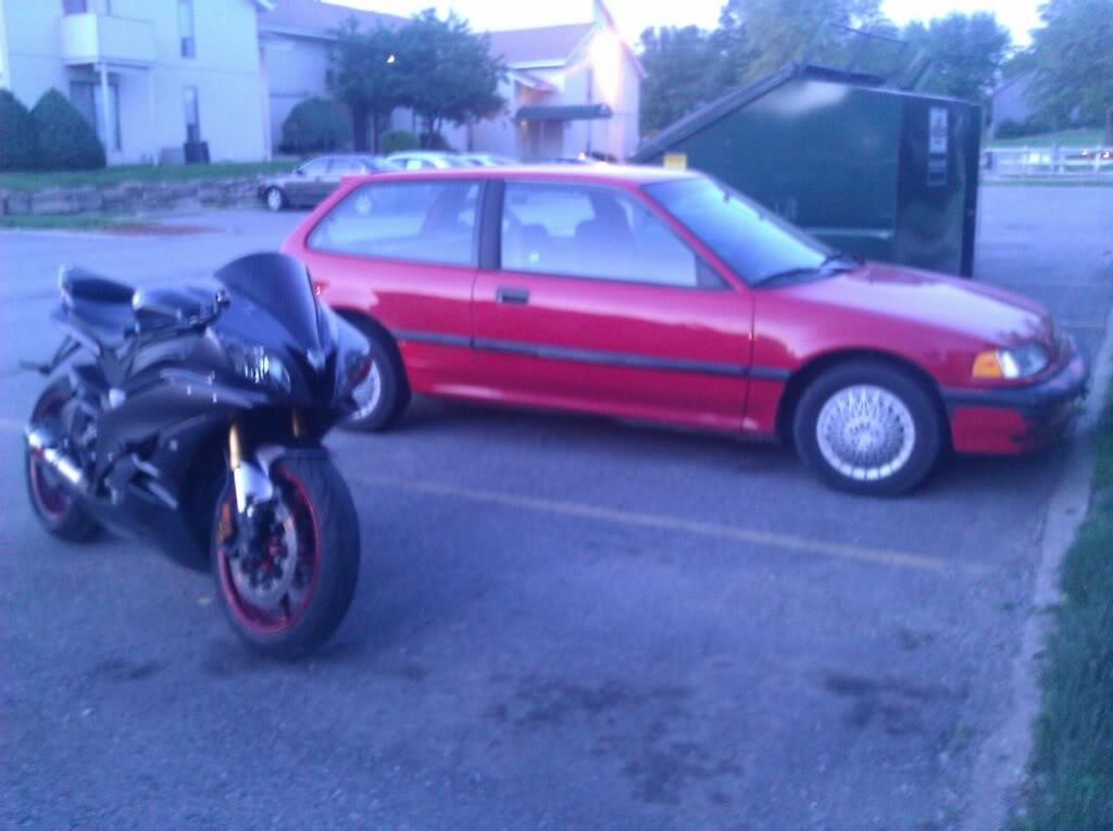

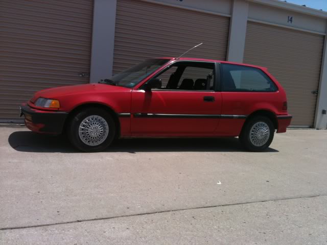

Here is a pic of my car that my buddy sent to me with it sitting next to his bike:
I'm also looking for a roof rack. Can someone give me some info on them and let me know what I need to be looking for?

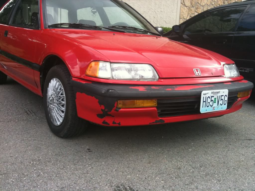

I like the progress you are making. That bumper is looking deadly. I had this same issue when my car was yellow. Those rubber bumpers that don't come painted from the factory don't like paint to stick.
I stripped down my bumper using bulldog bumper stripper if I remember correctly. I picked it up at a local autopaint dealer. Made the stripping much easier.
Also, I would recommend using some bumper adhesion promoter when you paint.
As for roof racks, thule or Yakima would be the way to go. They are a little expensive, but if you watch craigslist you can usually pick them up for the 200 dollar range.

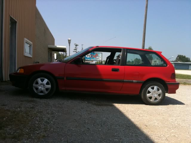

Car before:

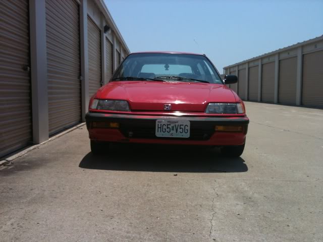

Front bumper before:

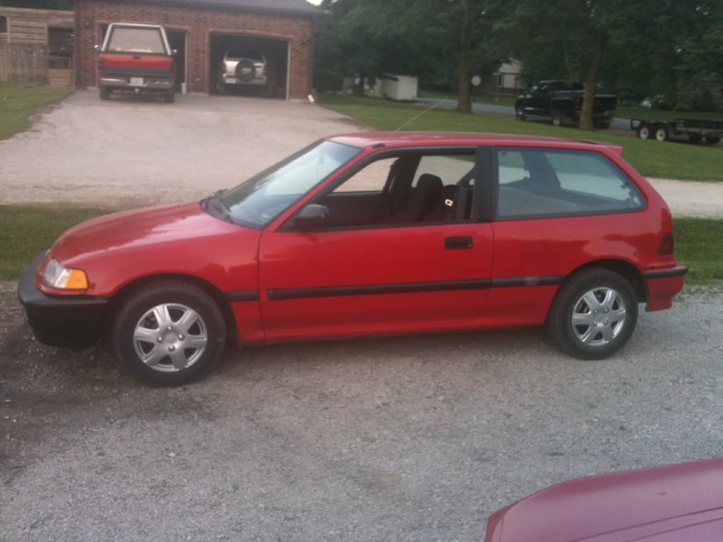

New hubcaps:

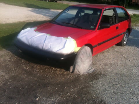

During the process:

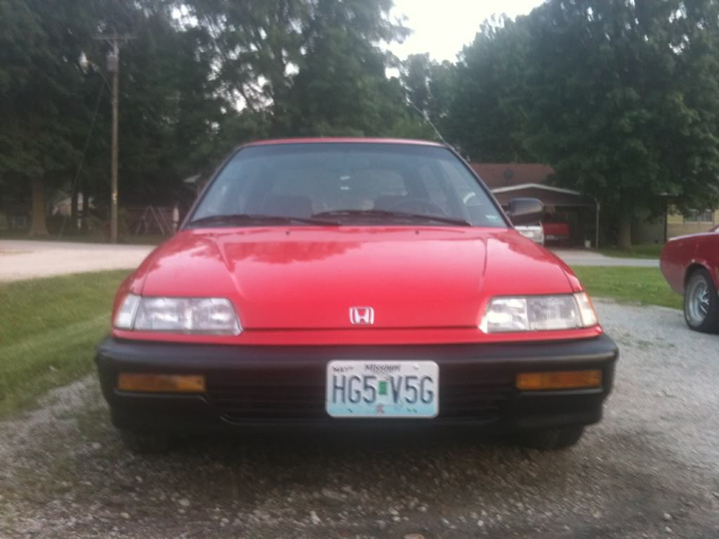

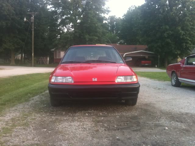

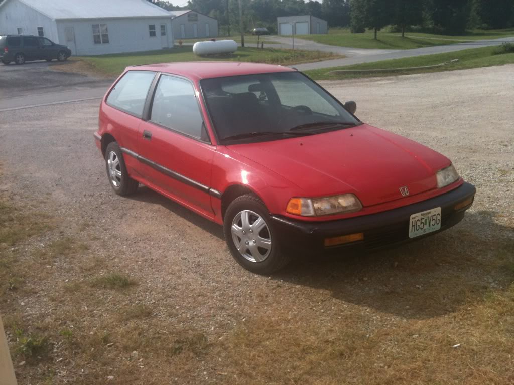

After painting:
After everything back on:
A couple after:

That makes a ton of difference. Looks MUCH better.
