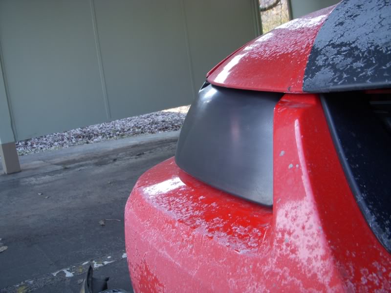

Anyway, projectors are done

Nice and flat black

so i see it snowed out in KY too? lol nice huh.. i like the new projectors man, gives it a meaner look.

I might have to wire them up to the parking lights until I get a switch, I'm not sure yet. I think I'll wait until I get the bumper and see if it even comes with the fogs and go from there. I know I could just PM the seller and ask, but the bumper should be here wednesday or thursday (that's a guess until I have the shipping number anyway), so I think I can just wait.
And yeah, we got a little snow here... it didn't stay on the ground long. the only places that have any snow right now are in the shade. And thanks, I think the flat black on the projectors really goes a lot better with the car than the gloss did. I still want to sand them down and start from scratch, re-spray the VHT, clear, and take them down to 2000grit to get them perfect, but they're good enough for now. I'll probably go a little darker once I have working fogs.

reaper- personally i like them shiny more sorry

No problem... I just thought the gloss black kind of stuck out on a red car with flat black accents. I think the flat black just ties things in a little better. Actually, I plan on switching the flat black to a semi-gloss when I modify the hood, so I might switch back to gloss black headlights.

semi would be a best of both worlds, i just like how clean the gloss looked. I know why you did the flat but to somebody who didn't know better it kinda looks like you didn't spend the time that i know you did
