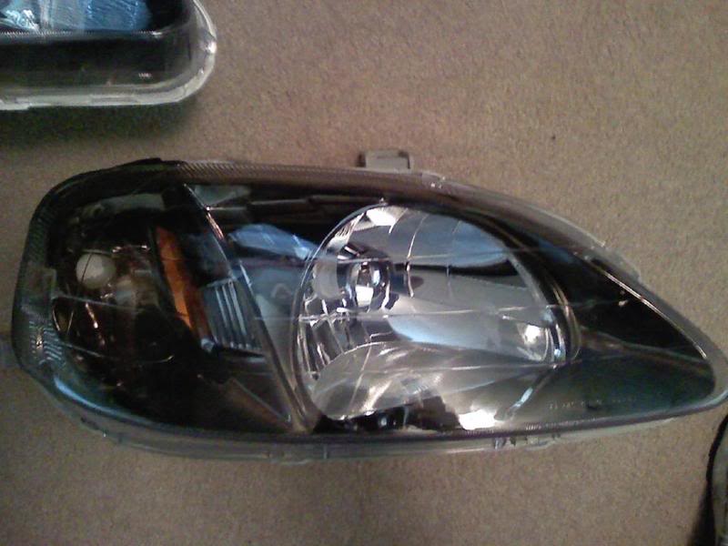

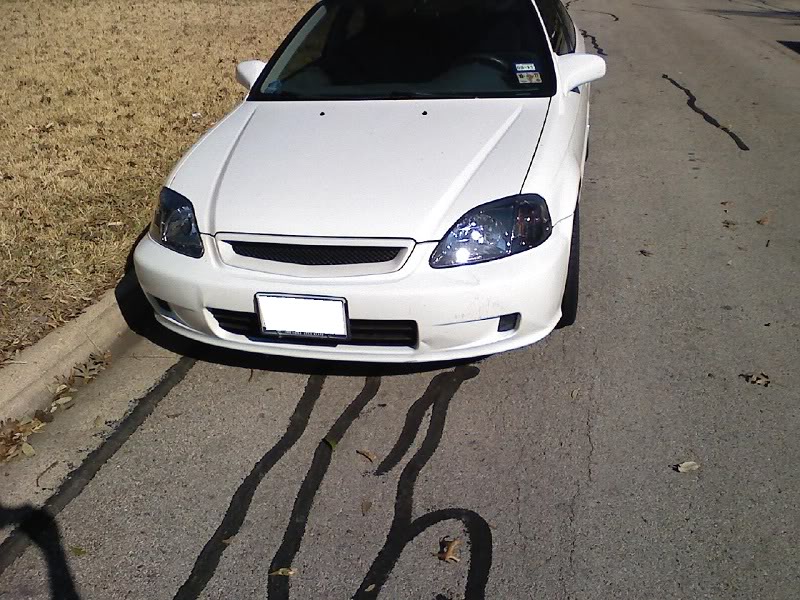

and heres a couple of pics of the current progress
headlights
headlights on the car

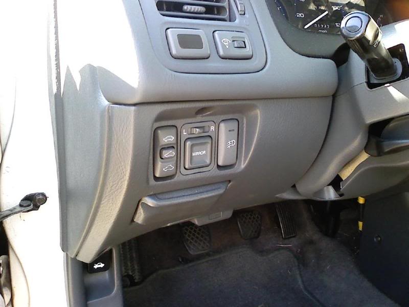

and the OEM foglight switch

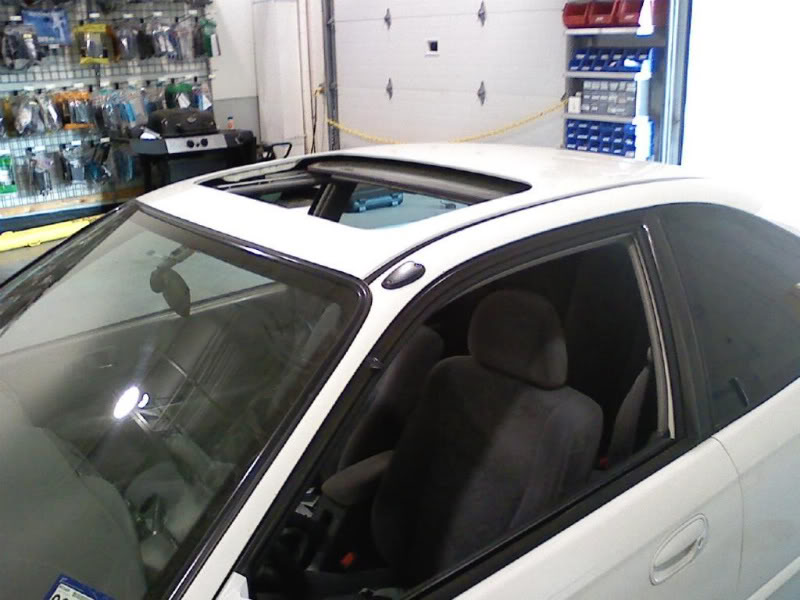

got a little work done yesterday. pulled out the dumb factory pillar antenna and put on the Honda block off plate. Looks much cleaner, I really like it.

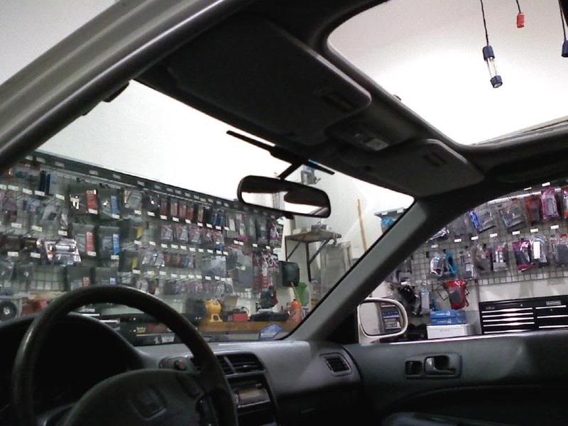

Also put in a window mount antenna to replace the factory antenna. I put it up behind the rear view mirror so its not really all that noticeable. The main problem I had with it was the ridiculously bright red led that was on whenever the antenna was on. but that turned out to be an easy fix. I ended up cracking apart the antenna and covering the LED with a small piece of electrical tape. Put it back together and absolutely no light shows through. problem solved. and the antenna works just as good if not better than the factory antenna.
Tomorrows the big day that I'm dropping off my car to get everything painted!! I'm hella excited. I'm getting a new front bumper, the rear bumper, both side skirts, the fog light shrouds, the grille, and the new si lip painted. He should have it done by the end of the week, but due to my school and work schedule I probably wont be able to get the car back it the following monday.
but heres some picks of the block off plate and the antenna.
block off plate
and the new antenna

ya the wire goes up under the headliner, then down the passenger side A pillar and zip tied to a support beam above the glove box over to the radio. And its grounded with the map lights.
The other option is to run the wire down the driver pillar and plug in to the junction point that is in the driver kick. That way you dont have to have extra wires behind the radio. but the problem with that is that you still have to run a power antenna wire from the radio to the junction, which is just making more work for yourself. So I found it much easier and less work to just pull out the radio and have the wire go down the passenger side.
If you are thinking about doing it, the antenna works great. I have reception on stations that were crappy before. Plus AM works great for anyone that uses it. Some window mount antennas suck on AM but this one works great. The one I have is a Metra 44-UA200.

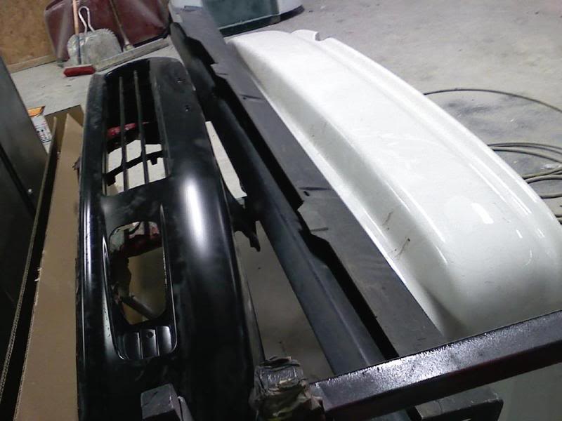

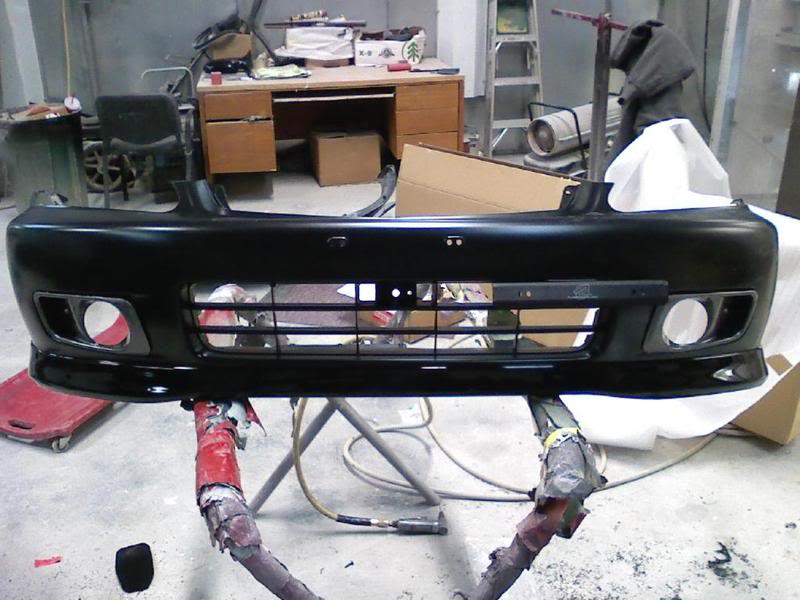

just a small little update. Dropped my car off at the paint shop. This is the same guy that did the paint on the bumpers and lips of the old hatch, so I know hes good. We got the holes cut and drilled for the foglights and the license plate relocator and test fit everything before it went into paint. The only thing that still needed to be done was fill the factory license plate holes, which my painter will be doing for me. He shold have it done on Friday, and as long as he sticks to that, I will be picking it up on Saturday. Cannot Wait!
but heres a couple of mach up pics

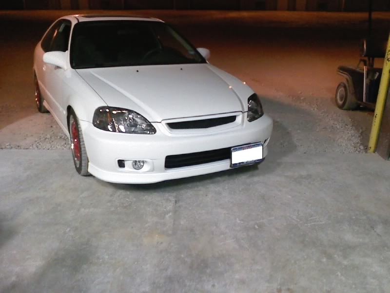

got the car back today. It's pretty sexy. Heres a quick cell phone pic. I'll get some good pictures with a real camera either tomorrow or monday when i have time and the sun is still up.
edit: the car is sitting on an awkward slope, so the stance of the car doesnt look normal
