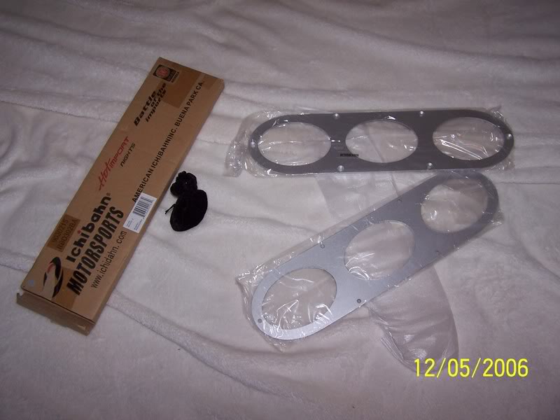

Here is a pic of them, forgot i even had this pic.
