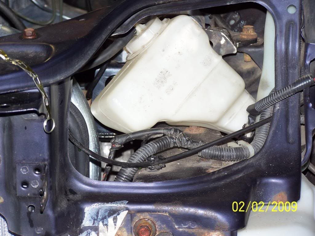

question.... why not flip the fan and put it on the front to blow air thru the radiator? J/W... or is it not reversable?
also i would clean off those radiator support welds and primer/paint over them again before those welds rust away....
doesnt look like the shop that replaced it they didnt grind down the welds and primer/paint them properly.
Old Feb 25, 2009 | 06:14 PM
  #79
SPLAT's Avatar
Posts: 1,996
From: New York/Up state
The fan cant be reversed.
And thouse welds were there befor, i found out later that the rad was replaced ( i bought the car 2nd hand....never pulled off the cover befor i bought it.....stuped me), but it will be getting primed very soon.
