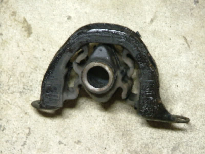

just installed the new lower left motor mount
old:
new:

Oh **** was it broken like that on the car?! Or did it bust takin' it off?
Old Oct 26, 2008 | 01:15 PM
  #34
I had to take it off when I replaced my drive belts about a month or two ago, and it just crumbled in my hands when I took it off.
Luckily, this is the lower left one (the one on the A/C bracket, by the crank pulley), and it's not one of the more important ones so I was able to put it off. Also, it was only like $23.

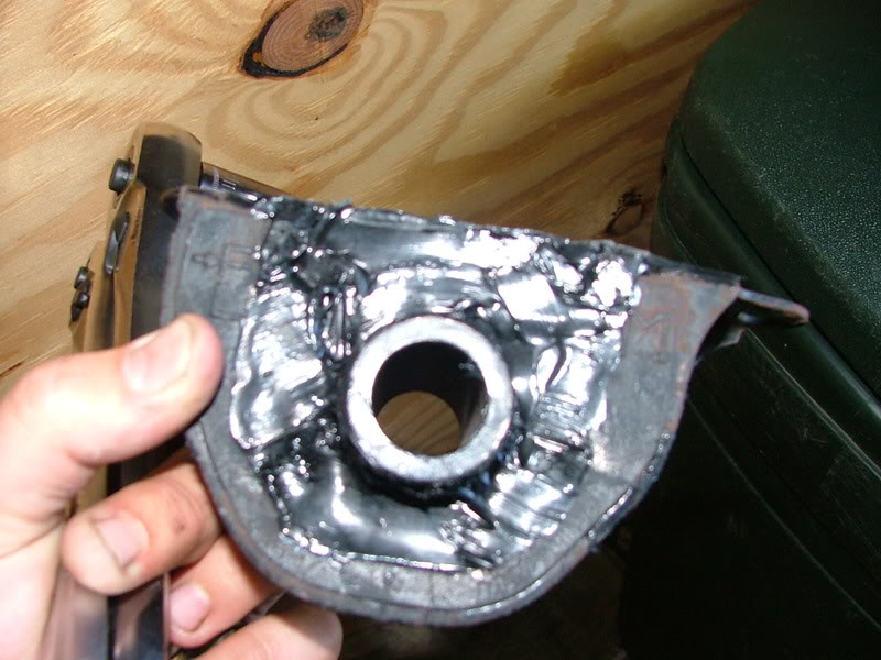

CRASH MOUNT! mine looked like that...pic Name:  DSCF1020.jpg
So then i filled it with 3m window weld which led to this
Size:  85.9 KB Thumbup for ghetto riggin
hahaa good work on the mount. right now im thinking about solid mounts for the ef, lol

haha for all intents and purposes...its the same as a new mount with urethane inserts. 3m window weld is a polyurethane...just not as pretty
Old Oct 29, 2008 | 01:04 PM
  #40
Does filling the insulator like you did increase or smooth out general engine vibration felt at the steering wheel and inside the car?
I also see oil on the original repaired mount. Is your power steering pump leaking?
