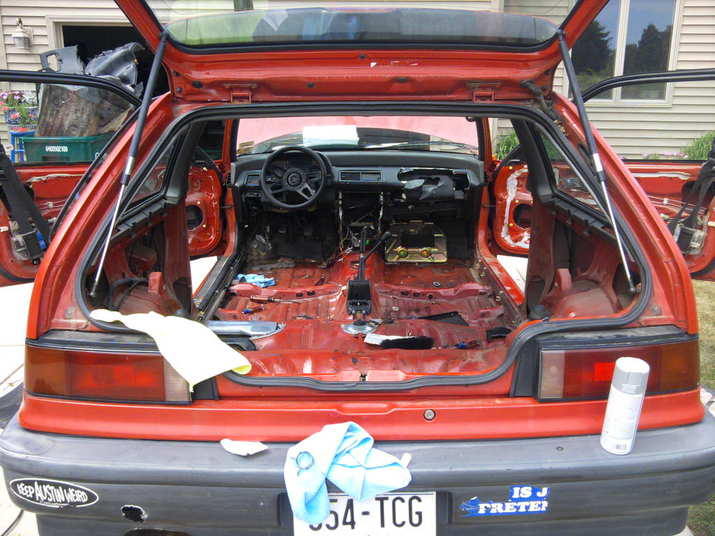

did a little bit of weight reduction today. and by that i mean i completly striped the entire interior. im probably going to get hated on for doing it but thats fine i guess. its what i want to do. its my project car so thats what its gonna be, a fun to drive project not a daily driver. so here is a pic of it now (or pretty recently im still cleaning the inside cause there's black gunk all over.)

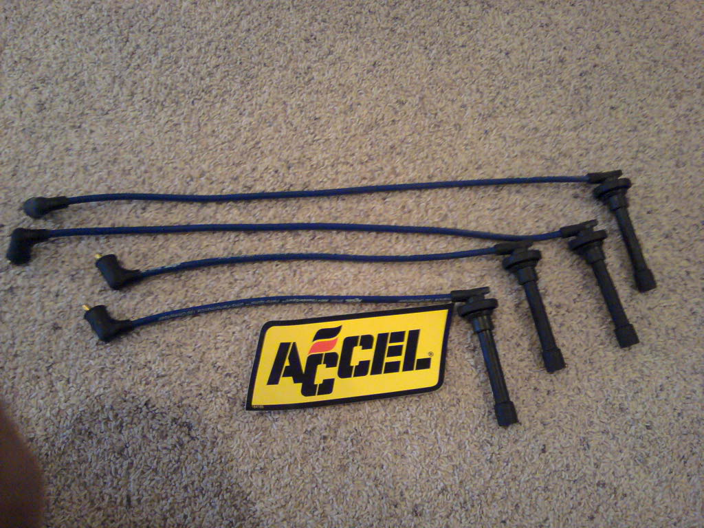

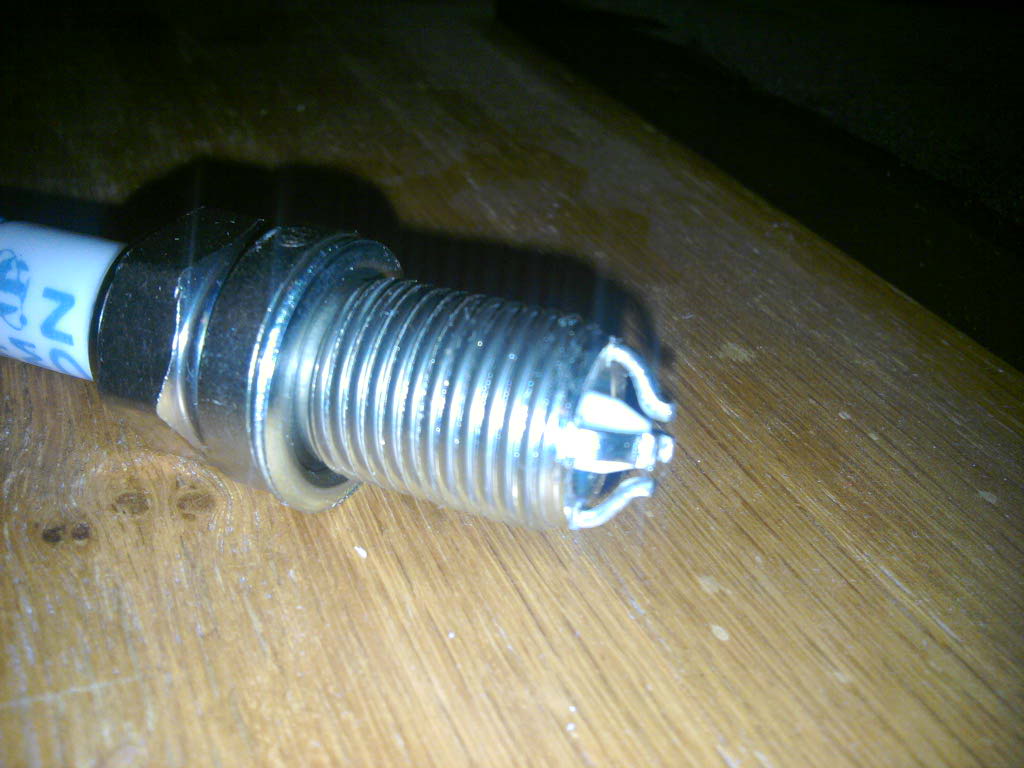

also got my racing plugs and wires. Bosch fusion's and accer 8mm wires.
if you're stripping the interior, might as well remove the sound deadening as well. every bit helps.
check out my build, you'll see it removed if you're curious.

also, if you plan on reselling the car, keep the interior plastics. it's hard to sell a car with a stripped interior, it just brings down the value. all that plastic doesn't weigh much tbh, and your car is gonna be loud on the interior. just some advice. if you like it, keep it. xD

btw i threw out the entire interior besides the front two seats, the visors (incase i race in sun), and the passenger "oh ****" handle lol. but i wont sell the car, and if i do it would be to someone who would like it for what it is. thankyou a lot for the input.

yea about the sound deadening i am going to keep that because i like the red interior. ill put some more pictures up to show how clean it is. i did find a lot of rust on inside of the roof, but it looks like its just surface so a little sanding/priming/painting will be in order.

yeah, true, you'd have the big primer spots if you remove the deadening. buuuut, you could repaint it underneath as well!!! =P

also, with all that you removed, i'm not certain it makes a huuuuge difference. there was a thread about it somewhere on honda-tech... rotational mass makes a bigger difference (i.e light weight rims, clutch, flywheel). lexan windows also make more sense, much lighter than glass. glass is heavy. but it's not street legal.
