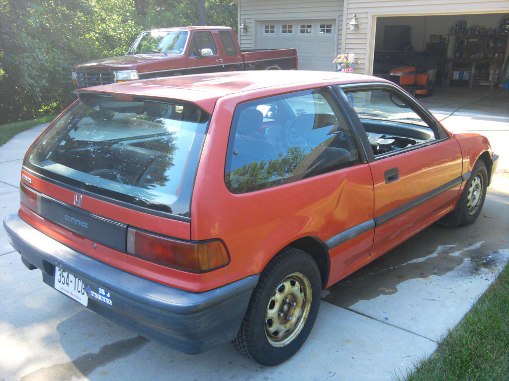

so i figured out im pretty much retarded. i didnt take the starter off. i took the starter motor off, not the whole starter. so i got that off, then it broke free. i needed to take a motor mount off all the way to get it out, which was fine, also the battery rack out, guess its time to relocate the battery =). anyway the next post will have pics of the civic. tell me what i should do to it. it all helps. and scott you have told me before you live in wisconsin, you live in Milwaukee i live in Madison lol. you told me to hit you up if i ever came over there. but yea enjoy the pics =)

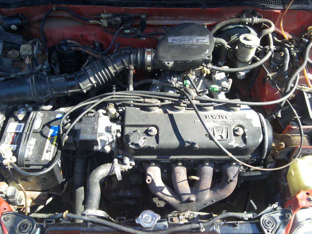

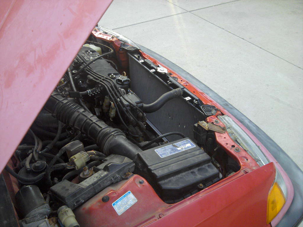

aluminum core radiator, first performance part ive ever put in =)

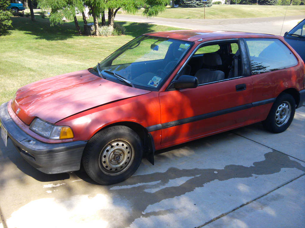

my civic next to my brother peter's project car, his audi a6
more will be added showing the headgasket change. but thats enough for now, hope it works

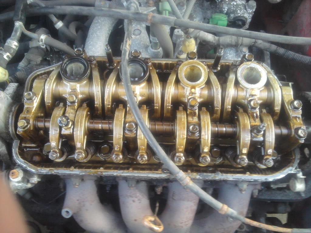

so first off was valve cover, easy...

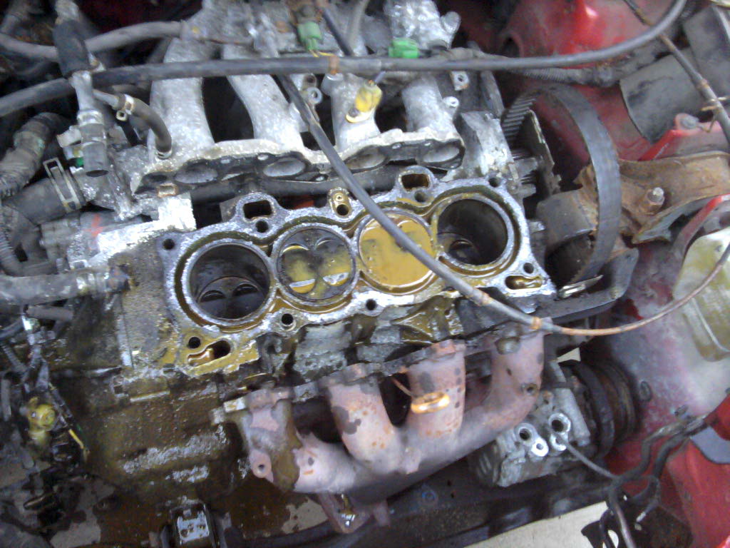

then take the head off. not really getting into much detail.

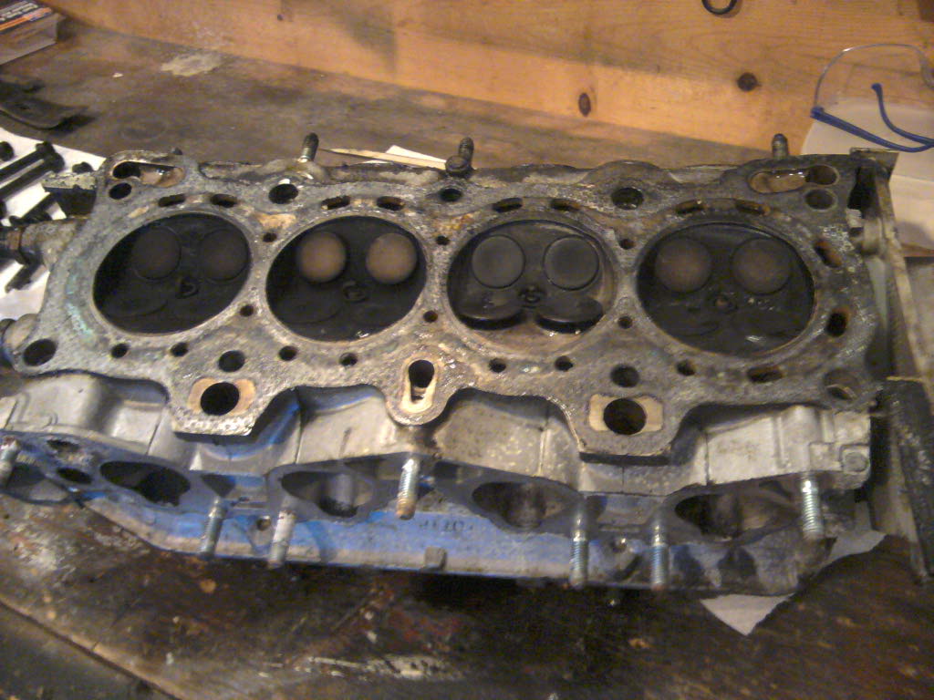

this is the head where the gasket was. time to clean it

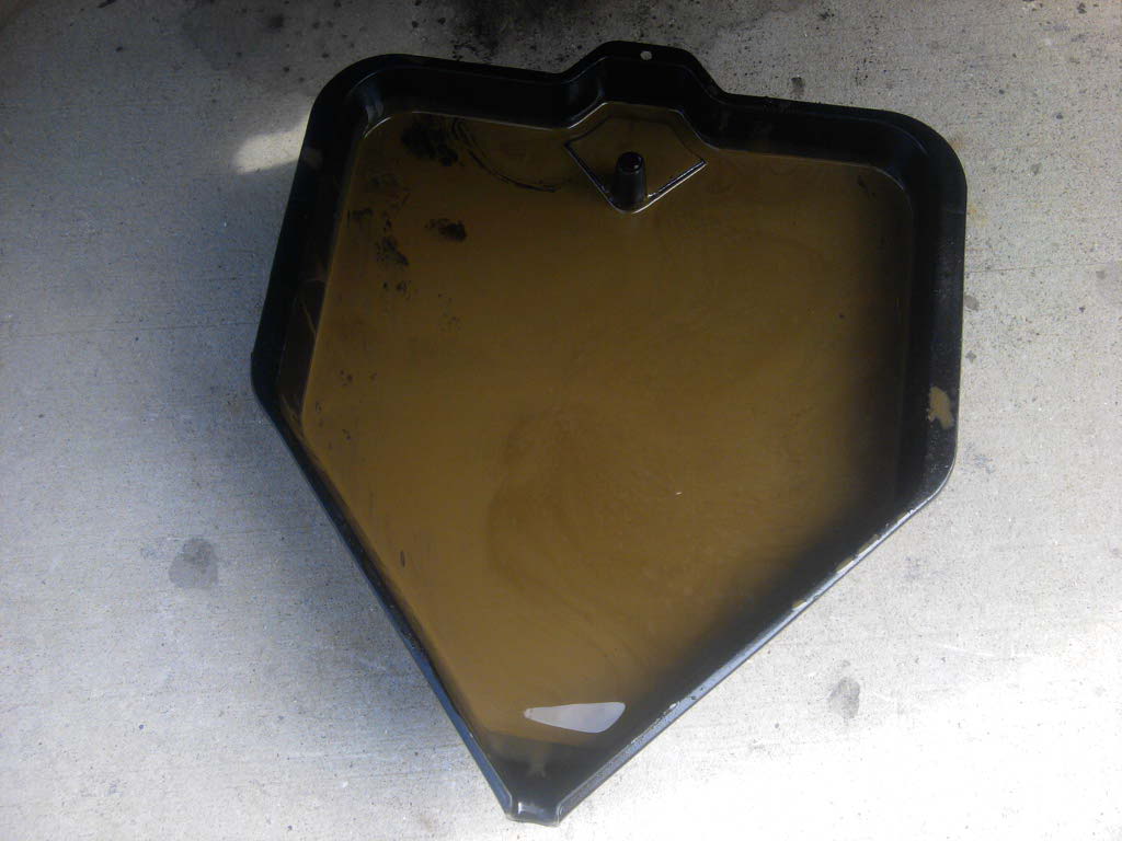

this is the oil that came out. looks kinda like chocolate milk.

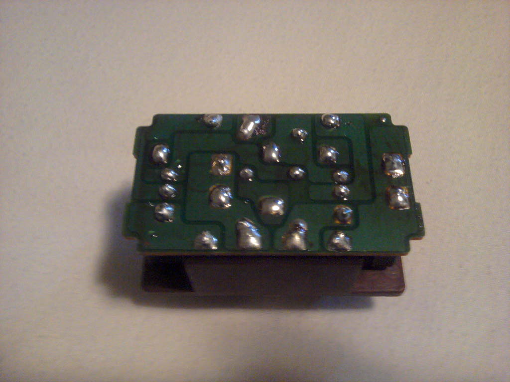

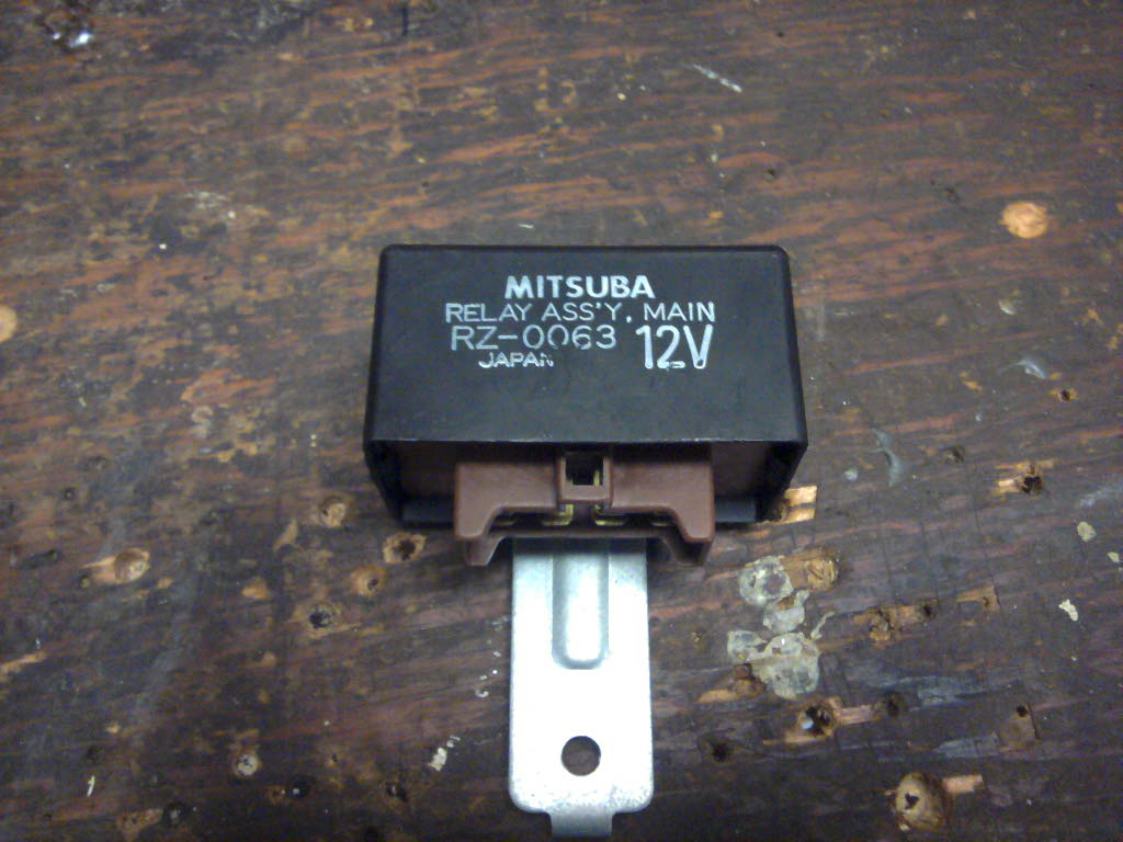

resoldered the main relay, i guess there was no problem with it but it cant hurt. Name:  612.jpg

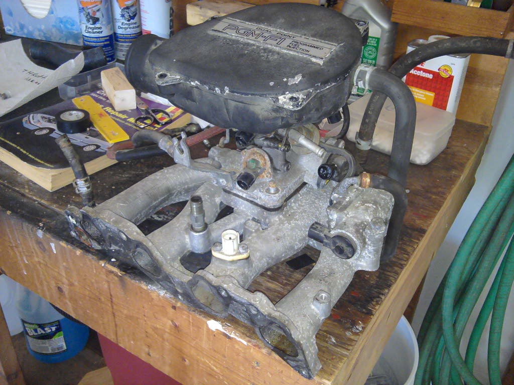

intake off

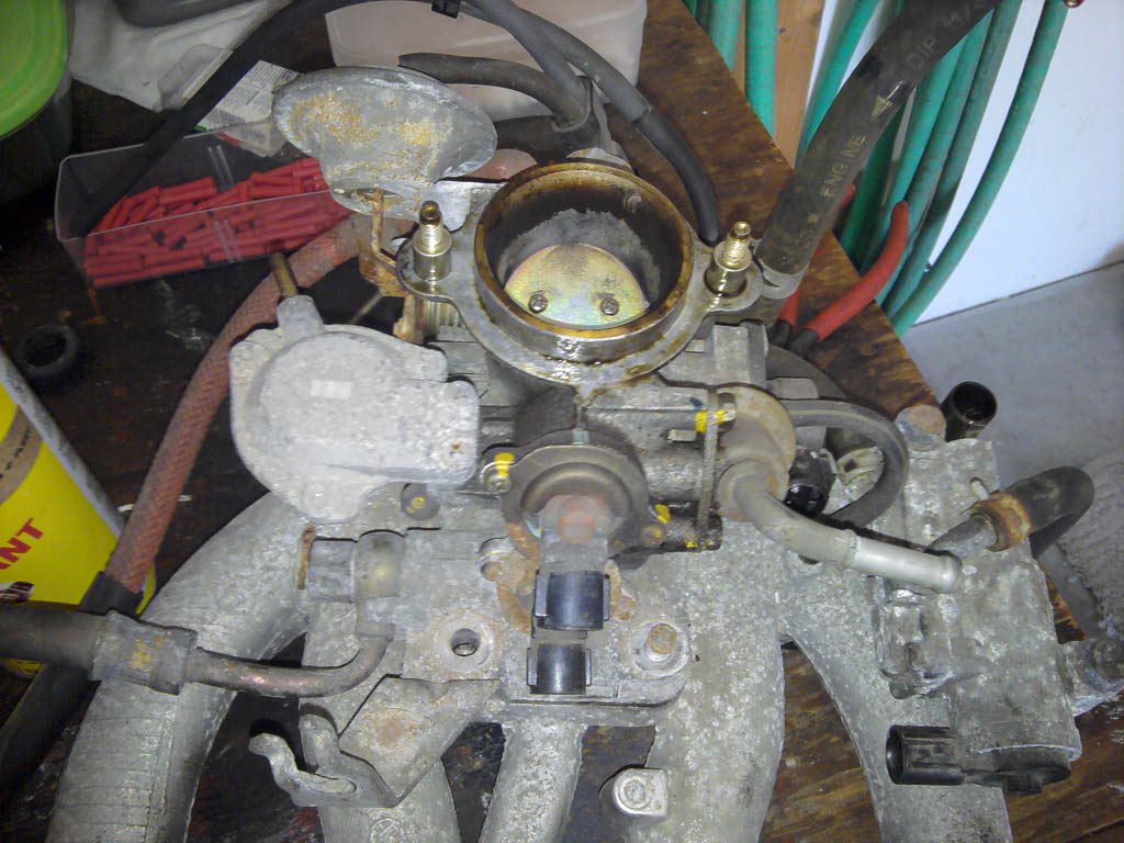

cleaned IACV (its on the bottom right of pic)

Nice. That car needs paint, but that can wait.
If you pull off the interior panels, you can probably just pound that dent out. it's not a lot of work, just gotta figure out how everything comes out lol.
I can't believe how good the body is on that car...
Few simple things: get a cluster with a tachometer, from a 90-91 Civic Si/CRX
you might like this How to Install Integra Center Console onto Civic - Honda-Tech
a lot of the stuff i know is for after you get her running strong. =P
look into the DPFI-MPFI swap. right now your civic has a glorified carburetor system, converting to multipoint fuel injection will really liven your car up again.
DPFI to MPFI writeup - HondaSwap Forums
basically you use a Civic Si intake manifold and distributor and ECU on your existing motor. 4 injectors are greater than 2! =D
looking good, keep it up.
