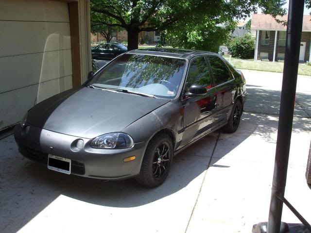

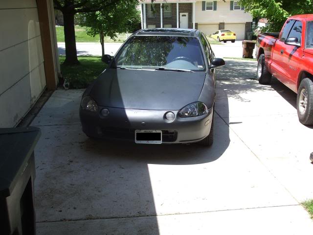

Today i got the magnaflow cat on and it sounds so much better then that test pipe. i also took a few pics... the swap isnt as clean as you all thought, but now that its summer, i have alot of time to work on it.
Sorry for the shadow on these two, i guess i should have moved the car back some.

Old May 18, 2009 | 11:22 AM
  #70
shes not to bad.... what i would do IMO for a cleaner setup is buy some new delso fenders and with either a cut off wheel or plasma cutter trim the stock fender and the new delso fender with it about 1/2inch to long so they overlap then install both fenders without the bolts just laying in place and with afew large magnets put them ontop of the hood and fender so they are level and it will hold your fenders straight then keep trimming the slice till it fits close and start tack welding it. with welding it remember SMALL TACK WELDS! give the time metal to cool and not build up to much heat since heat will make the panel warp like a **** if you get to much heat from welding OR GRINDING.... and for grinding dont use a grinder wheel use a flap disc grinder... its just like a grinder wheel BUT it has a bunch of sand paper flaps on it that smooth the metal down and wont build up as much heat so it will keep your panels from warping as much.
molding 2 fenders together can take some finesse so take your time and it will turn out good... you got a good start at least! ive seen quite a few that are just all hacked up with plates screwed to the outside of the fenders or just holes and zip ties holding them together...
im suprised someone doesnt make new fenders for the swap.
