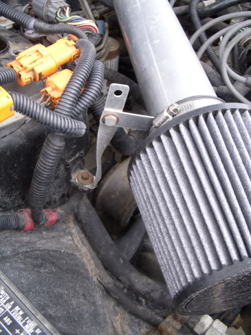

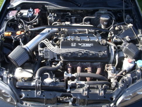

Two pieces of straight aluminum with holes drilled in them. Put a 90* bend in both of them, and a 90* twist above the bend in one. Then attach them like so:
Old May 5, 2010 | 12:55 PM
Spitfire Riggz's Avatar
Joined: Apr 2010
Posts: 111
From: Denver Colorado
awesome you knew exactly what i meant. Thanks so much. Ill post a picture of my current reinforcement so you can see how Sh!tty it is lol. Oh and how is the one thats actually attached to the pipe actually attached on there lol
