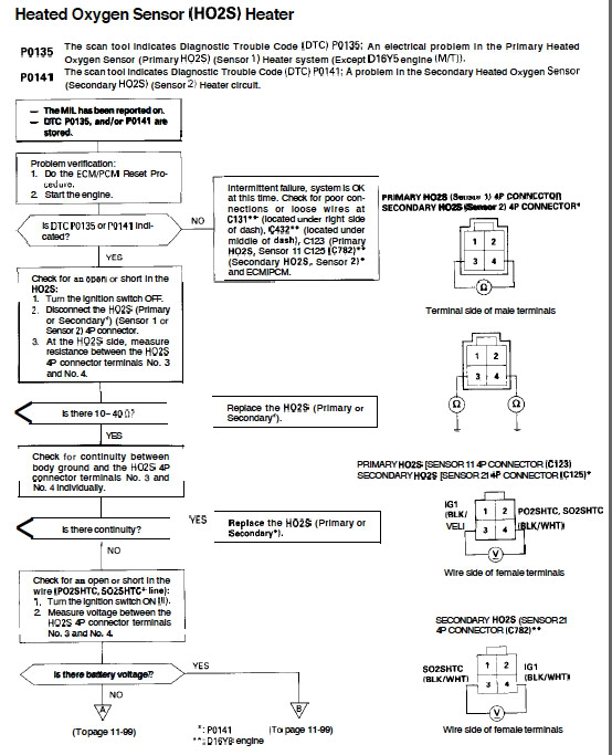

alright well i will try them both ways, however no one has been able to help me with my CEL. getting heater circuit malfunction codes for both sensors and even if they're both hooked up in the right places those are the only codes i get and they won't go away. it seems there is no current going through the heater wires. i really need help for that
Old Sep 15, 2008 | 05:19 PM
Check whether fuse 15 under the dash is blown.
Old Sep 15, 2008 | 05:30 PM
brutekiller787's Avatar
Joined: Jun 2008
Posts: 116
i did it's not blown but i replaced it with the spare anyway
Old Sep 15, 2008 | 05:44 PM
Did you clear the ECU to see if the codes don't return?
You may have an open or short in a wire that runs between the ECU and O2 sensor:
