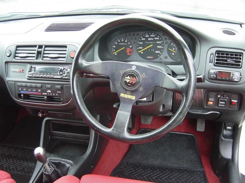

Ok, if your car is between 96-98 and your useing the 96-98 bezel?
Then yea, and that switch in the middle of the vents is really a vent closer, because on the U.K and Japan cars have a vent on top in the center of there dash, so you can open and close that vent. and it wont affect anything.
Also you cant use the U.S hazzard and defoger because they are way to large to fit in the pocket, so againg you have to use the JDM or U.K ones.
Iv seen people use the U.S buttion but over laps so much thats its kinda funny.

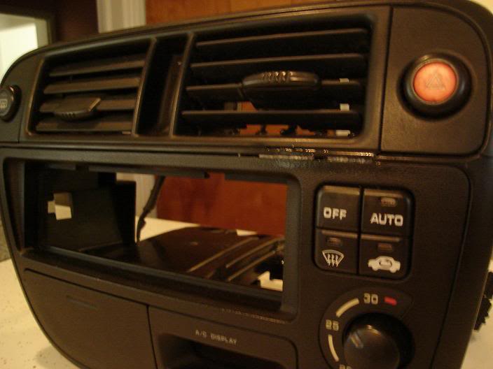

Anything will "work" with some fabrication.
I tried putting one of these in to my Civic a while back.
There are some wiring issues (good luck finding a good, understandable diagram). This isn't nearly as irritating as the vent slots not lining up with the actual vents on the CC unit.
You will need to cut back your existing (in-dash) vent slots, then fab up extensions to turn and route to where the vents on the CC vents are located.
Aside from that, and extending some wires, you should be okay.
